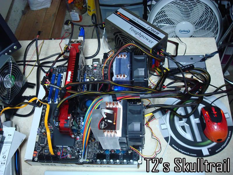

I was thinking about a chilled loop. But I am not sure the phaser would hang with that.
In the past two days my overal temps have crept up another 3C...I think three seperate loops would be the way to go.
Any thoughts on using a Phase Change unit to chill one of the loops? Possible set uip being Pump/Rad/WB connected to phase/CPU WBs/res
I've often wondered how a phase would work if you just added a waterblock to the loop and clamped that to the phase head...you'd think it would make a dramatic drop in temps right before the CPU or whatever you are cooling...

It's going to depend a lot on the evaporator style of the phase unit. Do you have a maze evap or a stepped evap with center cap?
You seem to have plenty of spare parts so I might suggest a slightly different route but, again, this is going to depend on the phase unit and what load it's charged for. you could pretty easily make a HX for your cpu and chipset loops by dropping your radiators into an antifreeze/distilled bath in a cooler and put a high flow waterblock against the evap and loop the antifreeze/distilled through the block on the evap and into the cooler to chill the radiator bath. Depending on the charge on the phase you may or may not need to mix antifreeze into your current loops.
IMHO, you'll either need a custom chiller with big(24+plate) HX evap or a triple head phase to really pull the most from any skulltrail rig.

The Xeons have been running a lot hotter than I expected. I even RMAed one of them because the Core temp difference was so radical...two of the four cores idled at 50C... The new one is more normal but they still run hot.
I'm building a larger cooler with three PA120.3 on three seperate loops so I think that will help.
I have reseated the waterblocks a number of times and used IC Diamond TIM this time instead of Shin Etsu but saw no real difference.
Just too much tubing and not enough rad or pump...the IwakiRD30 and the PA120.3 finally met their match :D
Coretemp doesnt read 45nm processor temps correctly. Realtemp does a better job.
Use a common res between the loops so you're not wasting radiator power ;)

We could probably figure out a TEC set-up for this thing but, even cpu and chipset only would be terrifying. we're talking dual E5420's and a 5400 here so, 320W Qmax pelts on the cpus and an 80w qmax on the chipset. Should be able to run all three at 10v to improve thermal transfer efficiency since we're not trying to dive too far into sub-freezing. but, this is still going to need it's own ~950W 12v psu so something likes of a 1200W ATX psu or a meanwell se-1000-12. Problem then is going to be dissipating all the heat from the peltiers. 320W qmax pelts require about 500W to transfer that much. cranking them down 10v will drop transfer to about 270-280w and draw to about ~440 for each cpu and 90W draw and under 7w transfer. Should keep all three just sub-freezing at load. Then you're just going to need a pair of PA120.3s to dissipate all the heat coming off the hotside. Remember, most pelts you have to keep them below 50C on the hotside or their going to loose a lot of efficiency. I'm honestly not sure if your d-teks can move enough heat to keep the pelts cool.
A tripple head phase unit seems overly complicated for my tastes but, would be a good option. A simple maze evap on the 5400 and a pair of nice stepped evaps on your cpus would work but, it's going to be a monster to keep them below freezing at load given your current temps and the 120W stock TDP each.
I would build a chiller if it were going to be mine. Assuming 220W each cpu and 40W chipset to be on the safe side you're at 480W or 1638 BTUs. The smallest HX I know of are about 6000BTU rated but, keeping the charge down and doing a R22/R290 blend would be simple enough and good for ~-30C with a good 1/3-1/2hp rotary compressor and a rather large condensor. Fan throttling to match load is going to be the hard part IMHO. Most single stage units are only throttling for a load difference of a single processor, not two and a chipset. You may actually need about a 2L reservoir kept pulled down to keep from having a big ripple in temps when you load it. I might suggest a pair of 120mm Kaze ultra 3Ks set up to go full bore at pull down with one shutting off after the fluid is down to temp and the second canrun down to 1500 rpm when the system is idle and throttle up at load. A simple temperature controller to keep the air temp within on the outlet side of the condensor within 10C of the inlet side should work just fine.

BUT, as I own two E5420 myself, I can tell you - they don't drain no power.
When running them at 3Ghz, my whole system pulls 220W from the wall while running prime SmallFFT, and that is with a rather inefficient cooltek 600W PSU.
These Harpertowns have an 80W TDP, but in reality, it's more like 60W each.
Getting them higher is rather a matter of high FSB (and therefore MCH, VTT and Vdimm) than it is of Vcore. Feeding those CPUs more than ~1,3V would be pointless even at 450 FSB.

I wonder why mine run so damn hot then.
Thanks for the info. I'll try lowering my Vcore and see if it will still Fold. The Transcend seems to be a weak link.
I don't have Vcore option in Bios, but that's not a problem up to 3,25Ghz, and even then I think my problem is the VTT.
I have two perfectly identical CPUs, both run at 1,16V Vcore loaded and 1,08V VTT...
The only 2 things running hot are the MCH and FBDimm, got to improve cooling soon.
Well I checked out Real Temp and basically it's just saying Tmax is 95C instead of 105C so Core temp is 10C high. Interesting premise.
But I found juicing the CPU(s) was working to make my rig stable for Folding.
Since I am under 100% load 24/7 I expected some heat..but not 63C. If RealTemp's premise is correct I have a much more acceptable 53C load temp.
