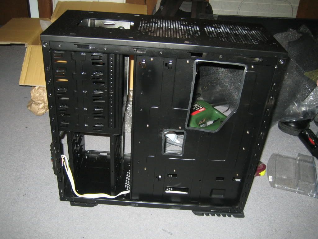

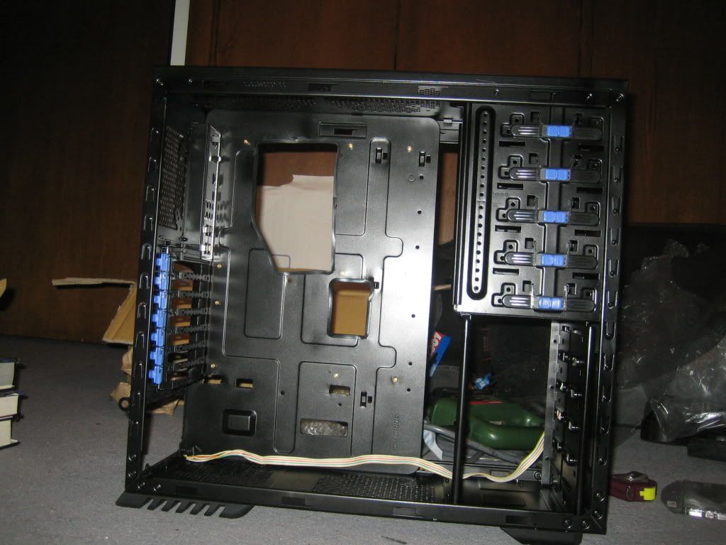

I used White Knight Satin Black Quick Dry Enamel, from my local Bunnings Warehouse over here in Australia.
Removing the HDD bay would require drilling out some rivets, and I figured it really wasn't worth the hassle. I've been able to get to everything I can see, so I'm quite happy with it.
It might raise internal case temperatures by a couple of degrees, but I'm not hugely worried. It'd really just be the metal heating up a tad, and the air flow should mean that the temps on the components don't change much.

Are you using trim on your back board cut outs?
I found the Fan trim from PC Case Gear worked out nicely to stop my leads rubbing on the sharp edges.

That's the same stuff I'm getting. The edges of the cuts are still fairly rough, despite being filed down, so I figured I should protect myself. I've already drawn blood once on this case :p:

So you sprayed right over all of the rivets (especially the ones on the back of the case)?
I was concerned about spraying over the nonremoveable ones.
Yep, if it wasn't a screw, and couldn't be taken out (without using power tools, anyway :p:), it was sprayed over. It would have been too much effort to drill out all the rivets, disassemble the case, paint it and then rivet it back together again, so I took the lazy man option and just sprayed everything :p:

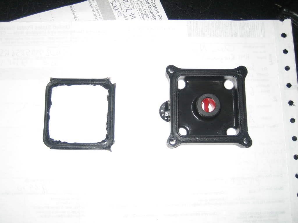

Also, have other people had problems with a lot of flash and mould lines on the O-Ring between the top section and the mid-chamger? That O-Ring is a bit of a mess, where as the o-ring between the mid section and the base-plate is clean. Pics will come tonight.

Mobo tray holes have fan hole moulding on them, to save both my cables and my hands/fingers:
Again, any apparent thin paint in these pics is just caused by the flash.

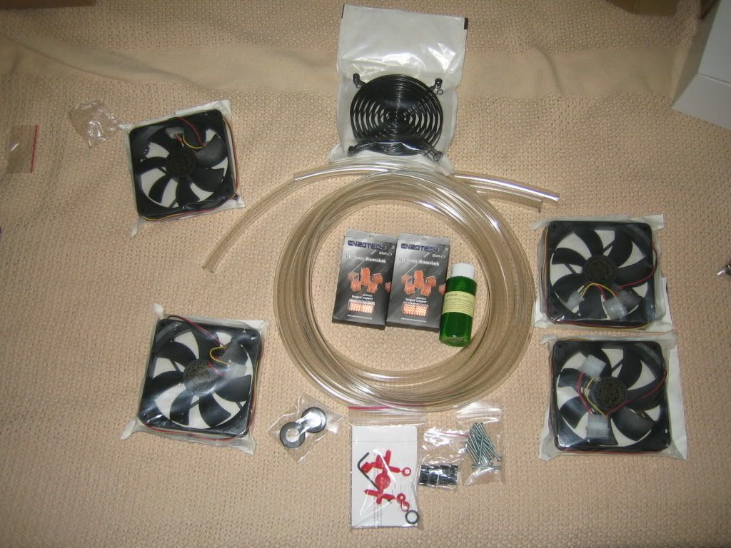

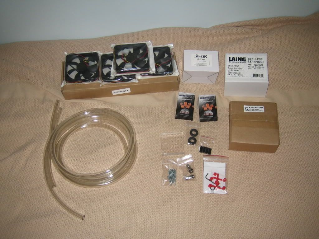

And like I said earlier, my water cooling is here! Yay!
Most of the stuff that came in the box:

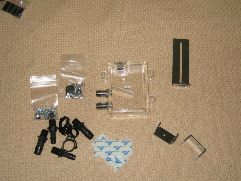

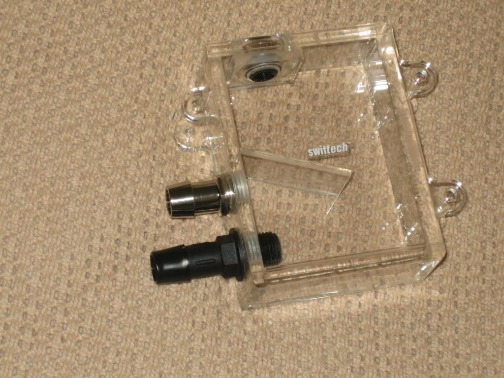

Swifty Micro-Res with D-Tek 1/2" barbs:

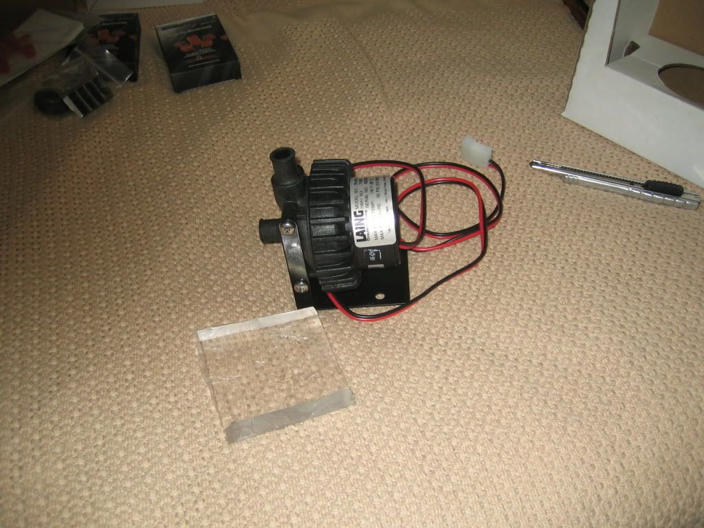

Laing D5 Vario, with Petra'sTech "GelStuff""

That GelStuff is cool :D It's all squishy and stuff.

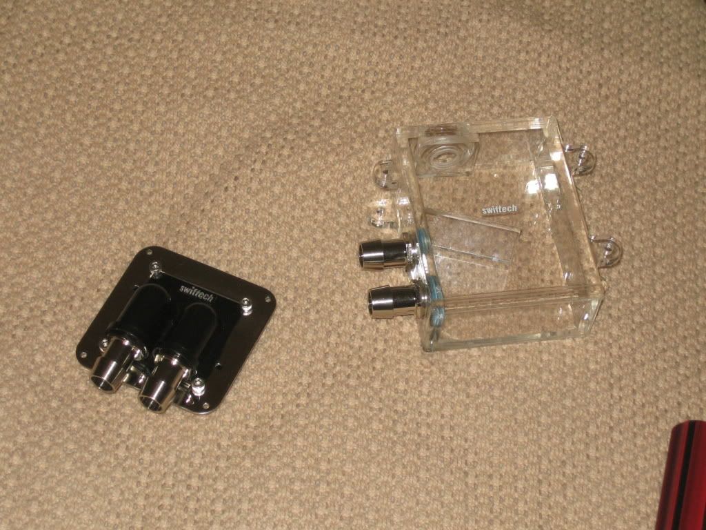

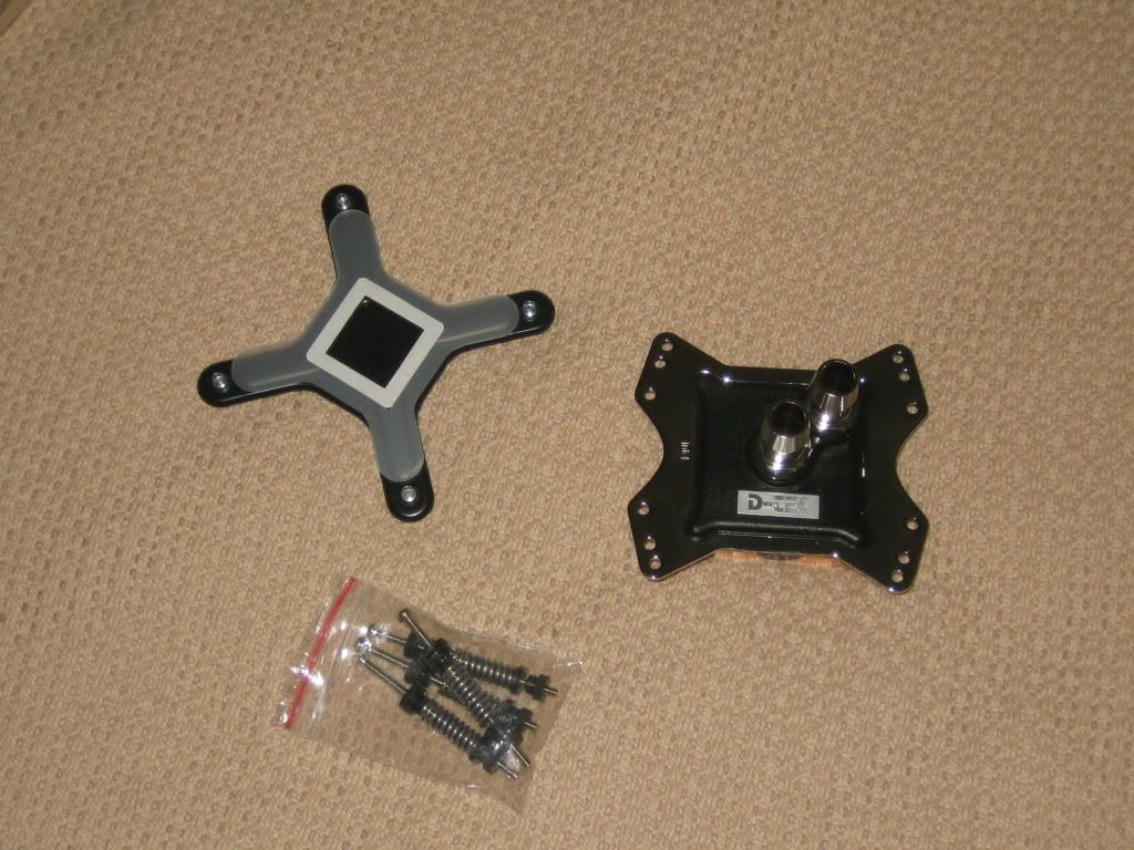

D-Tek FuZion CPU block w/ Thermalright LGA775 backplate (also using Accelerator Nozzles, but not shown in pic):

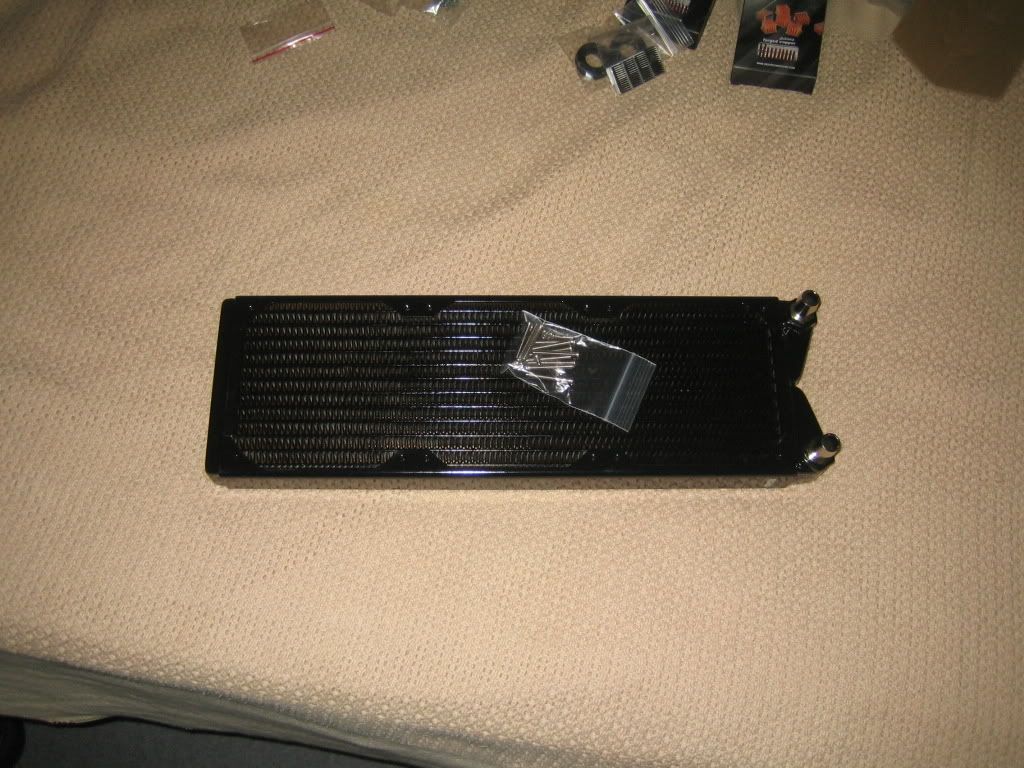

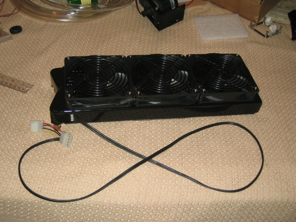

Swiftech MCR320 w/ D-Tek 1/2" Barbs:
http://i113.photobucket.com/albums/n...r/IMG_5694.jpg
I was a little worried when I first ordered this. Swiftech lists the fan mounting holes as M3.5, which when I went looking for screws are impossible to find. Turns out that M3 screws work fine, as well as the standard PC screws for mounting hard drives and just about everything in a computer case :p:
7/16" ID MasterKleer tubing, Swiftech HydrX, Yate Loon Highs, Accelerator nozzles, Enzotech Ramsinks, etc:

This is how the O-Ring between the top and mid plates looked on my FuZion when it arrived:
http://i113.photobucket.com/albums/n...r/IMG_5704.jpg
The o-ring on the other side was perfect. However all that flash came off very easily, and now both o-rings look almost identical.
Here's the wiring for my radiator fans:
http://i113.photobucket.com/albums/n...r/IMG_5709.jpg
The top two fans were a real pain in the ass to splice, since the black cable is continuous from the bottom fan. So I had to split the wire, strip a section, splice the fan wires on, and then heat shrink.
Other side of the radiator sports 3 more black fan grills, plus some fly screen to act as a bit of a dust filter.

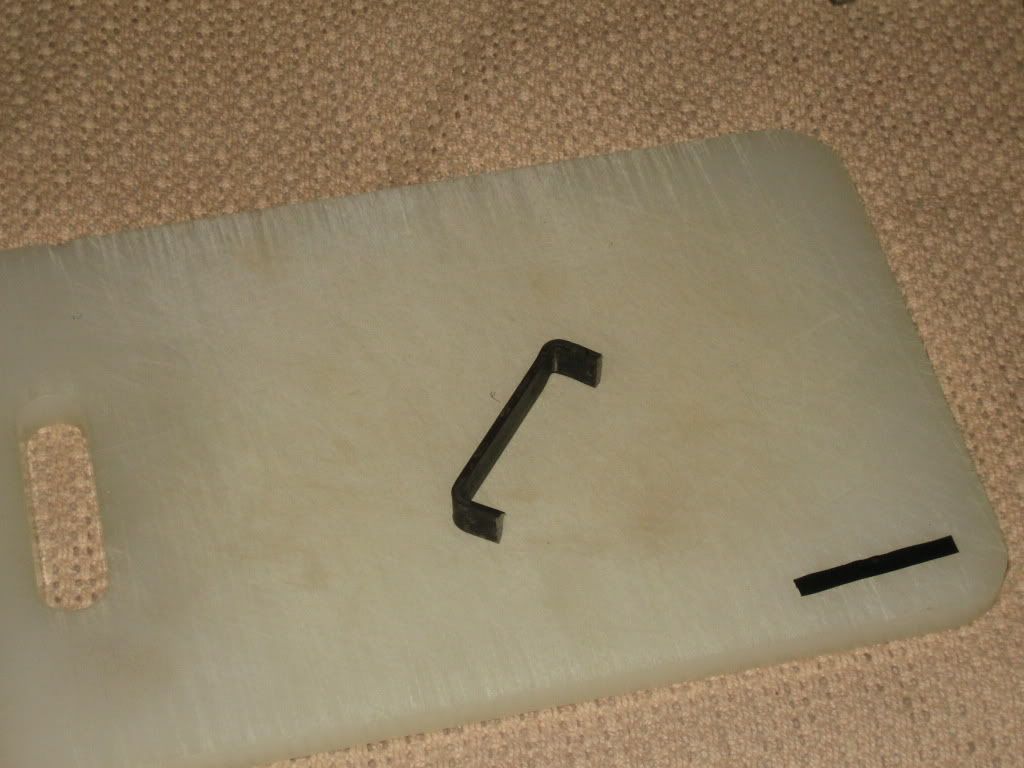

And I haves me a prototype U-Bracket for mounting the radiator onto the back of the case:
http://i113.photobucket.com/albums/n...r/IMG_5720.jpg
That's 12mm x 3mm steel, and is an absolute pain in the ass to shape. I might have gone slightly over the top. My current production facilities (vice attached to a bench, plus a small sledge hammer) aren't quite up to the challenge of making 4 of those, so I think I might have to see if I can find something to double as an anvil...

See if I can find suitable U-brackets, or else either some thinner steel strips, or else aluminum. I've given up on trying to hammer out that 12mm x 3mm steel stuff, and it's massive overkill anyway. I damn near ripped the vice I was using off the bench making that prototype bracket :p:

The 7/16" ID 5/8" OD MasterKleer isn't that big. D5's use oversized 1/2" barbs (which are an absolute pain to get 3/8" tubing over), and DCC + top was more expensive (plus constantly out of stock). FuZion comes with 1/2" barbs (and are glued in, so a real pain in the ass to get out). 7/16" ID MasterKleer is cheaper than both 1/2" ID and 3/8" ID. Plus with 7/16" ID tubing on 1/2" barbs, I only need to use cable ties to make sure everything stays attached, while 3/8" on 3/8" needs clips, costing even more.
So it just ended up being a lot easier and a lot cheaper to use 7/16" tubing on 1/2" barbs.
