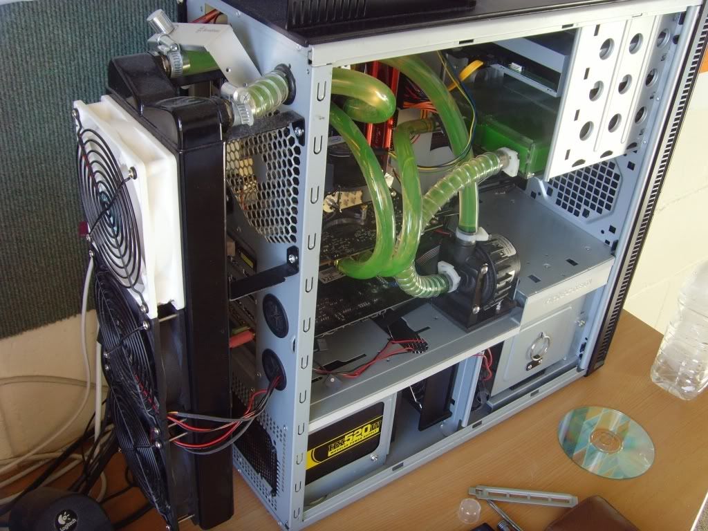

What do you think of setting it up this way. I canīt give you any advice cos i donīt know the lay out of your case. With this setup, i can remove my watercooling components completly from my case intact without draining my loop. I hope the pics might be of help to you:D .
