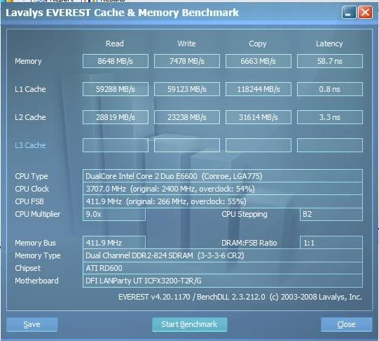

here's what I've got in like 10 mins with my Cellshock DDR1000 CAS4, using 2.25V:
http://i107.photobucket.com/albums/m...er16/wierd.jpg
this chipset doesn't like 1T, whatever I do I can't even boot to windows with it at 1T, and I'm not giving my RAM more than 4 Driving strength :shakes:
EDIT: your nforce680 result is kicking my board's butt, Rattle :rofl:

can you tell me your settings for that 1T setup on -the ICFX? cause I just can't make it run 1T.
on settings I mean: driving strength, voltages, strap, etc.
thnx
driving strength ------weak
voltages ----2.26vdim ,1.475 nb
strap---------- 1-1(sync) always or pointless
cellshock ddr1000 5-5-5-15\\\ 2x1 gig sticks d9ghk
ram running at 4-3-3-9 ddr800 1t rd600(icfx)
on dfi 680i 4-3-4-10 ddr 800 1t same settings
things to try-
1st-- lower that overclock! your "E6600 L632A407 w/ Storm Rev.2 @ 3.7GHz 1.536V" is not a healthy overclock to begin with(1.536V?)yet your trying to 1t your ram with it?try my cfg 400x9 with 1.45 vcore,1.475nb, then 1to1 your ram at true 800 1t.i tired 3.73ghz and it was wayyyyyy to squirley for 24\7 gaming use,let alone prime stable.
2nd---once your lower your cpu clock a lil bit(3.6) then try running 5\5\5\15 1t then widdle your timings down.jack your squirley cpu clock back up and watch your ram fail again.
please lemme know what happens for you,im glad i could hopefully help u.im
%95 percent sure that higher voltage cpu clocks,along with raised fsb on the ragged edge for stabiltys sake on a water system like mine with your same cpu\mobo that 3.73ghz at 1to1 would put your ram at 824 or so.so right from jump your trying 824 on the ram at 1t?this is another reason to lower your clock at first and see how high ram can run at 1t period for you.try the 400x9 and set EVERYTHING in timings to AUTO except the 1t option and voltage to 2.2.6v and it should boot right up.1.45for nb NO MORE is needed.and i need 1.475 for my e6600 to be ROCK solid at 3.6ghz on my icfx rd600.see what happens at 3.6!!u can fry your 6600 at 1.56v at 3.73ghz later,lol....
yeah, will try at 3.6GHz, but you can imagine how it's fried @ 3.83GHz with 1.6V :rolleyes: (stable in all but orthos, very strange, but can only do 3.7GHz +maybe 2 more FSB to be orthos stable, and it's not the chipset because with x8 multi it goes to 440MHz without any effort)
hmm, this is strange, it won't pass the code 95 with 1T, no matter I throw at it, 3.6GHz, even with driving strength 4, timmings 5-5-5-15 (and that was desperate), even if I raise the NB + related voltages, I've tried everything, no go.
It seems I get best results with 535MHz CAS4 tight timmings, read = 8820MB/s 13.250s 1M Pi, will tweak that for now.
I will, but somehow I think it's not the sticks :shakes:
