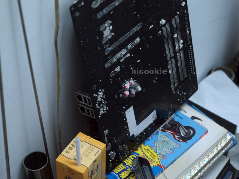

Hipro5,nice done there
ihave mod this one month ago,seems working fine to me
with quadcores 1.95v stable
just add some caps on the backside,and it's won't bother to ur cpu insulation:)
http://pic.xfastest.com/hicookie/asu...a/PA022892.JPG

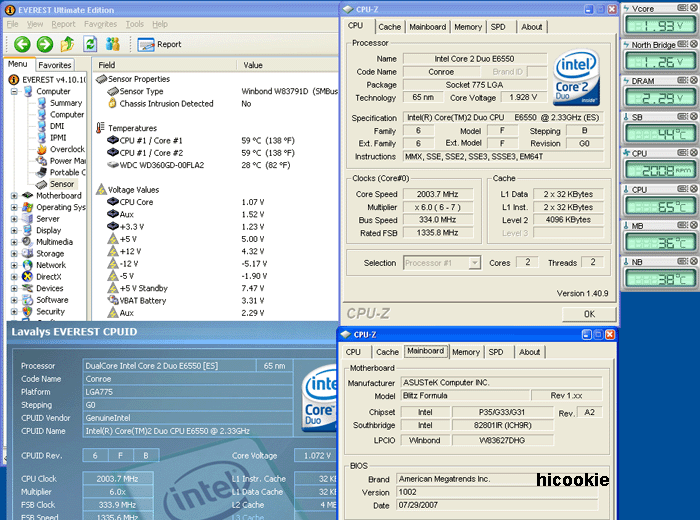

http://pic.xfastest.com/hicookie/asu...09.01/5160.gif
with intel stockfan 1.93v
http://pic.xfastest.com/hicookie/asu...WIthdamper.gif
wow that is ghetto modding at its finest :D
lol hicookie you're crazy dude
1.93v with intel stock cooler hahahah
anyone know where the vcore readpoint would be?
You... You... You put chokes on the bottom of the motherboard.
That is like, the smartest thing in the world.
