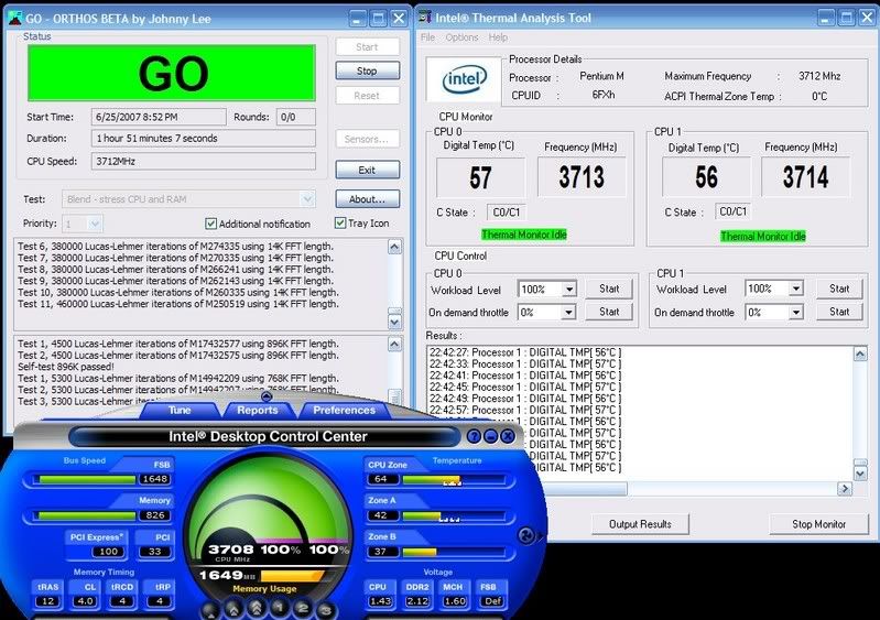

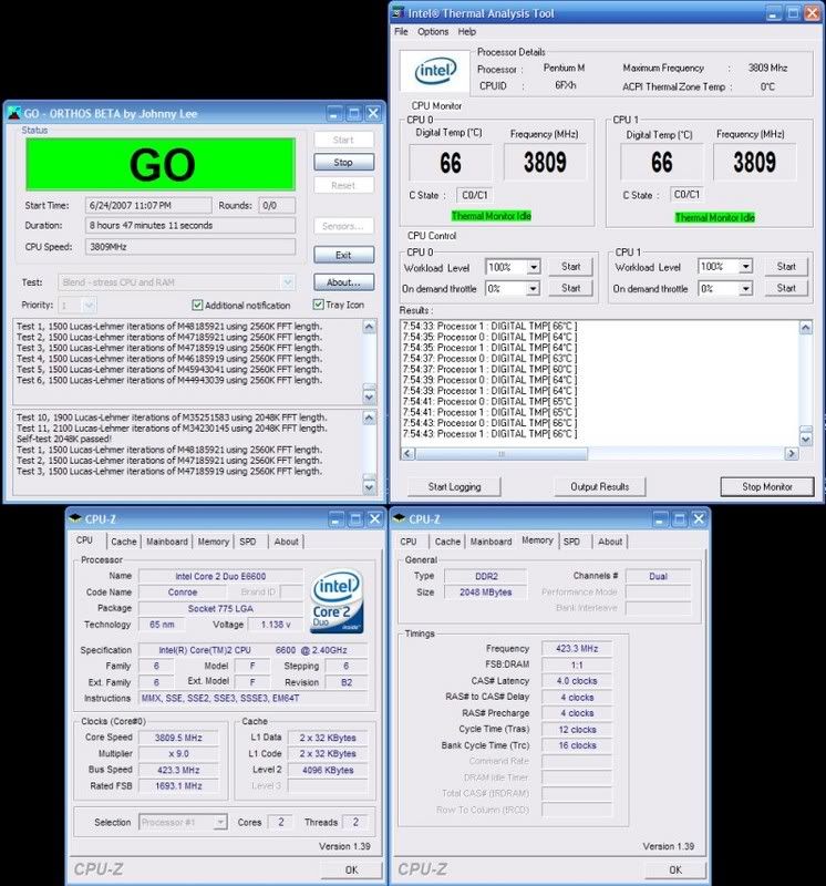

This puppy is pretty toasty now after running Orthos all night in 80F room temperature (makes a nice space heater). Nothing scorching or anything like that, but nice and warm. But, looking at the TAT temp reading, seems to be doing the trick, kinda high for sure, but with 80F ambients, it got its shakedown and survived. All while running the fans at a nice quiet 7 volts, I love it! Time to ramp up the speed some more and see if that works (nice lower voltage 627B chip, but it really belts out the heat, lol)

A little update...seems I got some bum Ballistix, I have really bad luck with memory, second time out of 2 times this happened. Did some testing and the memory doesnt do its rated spec with memtest, so something's funny there. And the random lockup at 423 MHz even after a 8 hour Orthos run is weird. Either that or I dont know what I'm doing, but I tried pretty much all MCH/FSB/Memory voltage combos, straps, timings, and speeds, still doesnt work right. So I put the old Corsair memory with those high-bandwidth :rofl: Promos chips in them and am just running it at 3.7 GHz now. I will cherish the day I buy some fancy memory and it isnt DOA or refusing to do the rated spec.

Amazing how .09 volt and 100 mhz can heat things up. Ambients for this testing run of 3.7 Ghz are one or two degrees less at 78F, but warmed up and running Orthos it is some 8 degrees C less than 3.8 Ghz. Now if I could get this thing to boot at 3.9 to see what temps would be like there, but no luck so far without pushing more than 1.55 vcore or if memory is the reason for the no boot, hmmm:shrug: Guess I gotta wait for a RMA'ed set of Ballistix that can actually come close to running the advertised 500 mhz to see which it is ;) Yeah, I could change the divider, but not real confident in how accurate that would be to judge the cause, as I'm not really confident of my 975X at this FSB.
