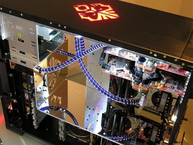

Thanks for the compliments. Just if people were wondering, my inspiration comes from admiring elegantly designed PC's such as VoodooPC. May not be anyones favorite on these forums because of their astronomical prices and many prefer to build rather than buy, but you'd hard-pressed to find a more classy integrator.
http://i47.photobucket.com/albums/f1...pen2resize.jpg
This is what I was trying to emulate.
Well you did a great job emulation it :)

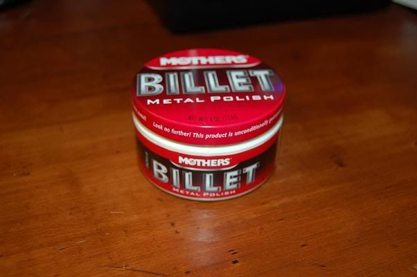

This is what I used for the final metal polishing...
http://i47.photobucket.com/albums/f1...DSC_0009_6.jpg
Mothers™ Billet Metal Polish. Its very pricey for this small - $20 USD - 4oz can, but you don't need much of it. And I've rtried alot of other stuff and this is the best I can recommend. Remember, take your time and don't rush and it'll turn out super nice.
