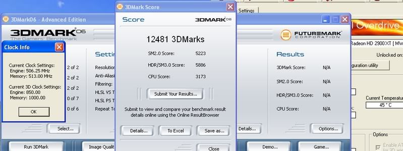

I have got my card today... i just can't make run 3D06... games run fine.. (Good quality, i m impressed..) any tips at launch? ( the screen of start of 3D06 stay.. i have install the version coming with the card ( Full version of 3D06)..
Badly my OCZ have be kill this morning, so i have need use a Enermax 620W Liberty.. with the 2x 6pin PCi express...
someone know if the demo of Ruby is leaked allready ?
add "-nosysinfo" to 3DMark shortcut.
Thanks cadaveca,,,

for the 3DMark boot up issue:
rename/remove the file called "direcpll.dll" from windows\system32\Futuremark\MSC -folder (WinXP, under Vista this file is in a different folder, use search to locate it)
other option is to use "-nosysteminfo" switch in the 3DMark shortcut, but then you wont be able to send results to ORB
so the other way allows submissions? I wondered how people were posting screens of 3Dmark recognizing the card, but my 3Dmark is blank!
Thanks Macci!
Vista file location : C:windows\system32\Futuremark
file removal works, BTW.
