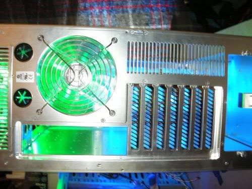

Yes, it's a PC-A70. I just recently got one myself, after they finally became available in Australia.
Though it is a little different to the one Ediejo is modding; the rear fan port has a wire grill, and the back exhaust port next to the PCI brackets has long holes, instead of round holes.
And it's only either silver or black (unless you paint it)
here's the rear of my PC-A70, so you can see how it's different:
http://img.photobucket.com/albums/v1...PC-A70rear.jpg
