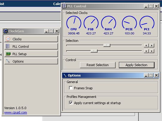

U can use Clockgen and just do this:
http://666kb.com/i/al3y0t5j722iz8zpu.jpg
O'RLY?
Hehe.. just kidding. Didnt know that. Well my solutions works fine too :)
