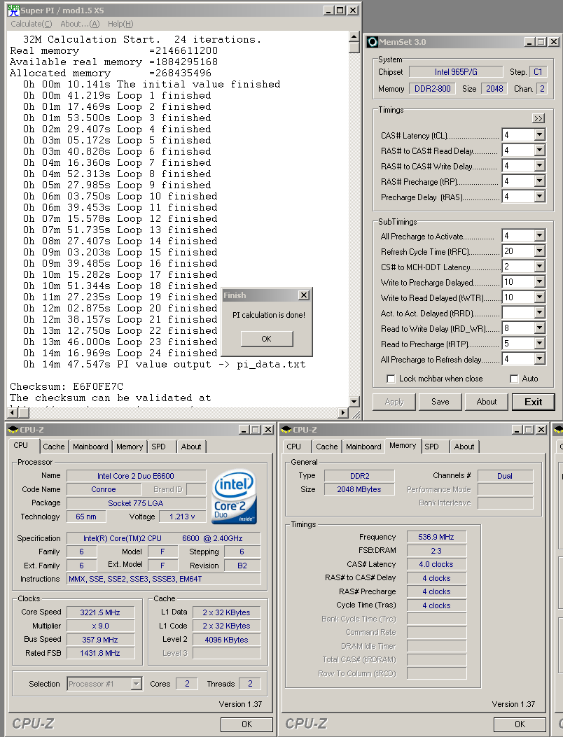

By the way, I'm not trying to get in a pissing match with you. I have a great deal of respect for your skills. But I think a distinction needs to be made between modded and unmodded boards. Micutzu did 490MHz @ 3-3-3 with 2.7v and the same TeamGroup memory. I'm just showing what can be done with an unmodded board.
The Pi times suck because I booted into Windows on the 1333MHz strap. I'm just trying to find the ceiling for this RAM. Then I will worry about tweaking.;)

ok, many benchmarks coming up, so please be patient while I post them all.

Again, MHz Wins...

Quick Analysis.
going from 367 to 460, gets a higher Minimum frame rate, and a higher maximum frame rate but doesnt effect the average frame rate much.
going from 460 to 550, gets a higher average frame rate, and a higher maximum frame rate this time.
the difference between 367 and 550 is definatly enough to warrant using MHz more, then cas, when in a game.

The 975 vs. 965 debate is getting very old. I have both. For RAM testing, the P5B Dlx is one of the best boards because you can hit memory speeds that unmodded 975X boards simply won't reach.
