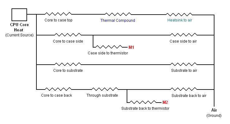

zalman 7000 alcu, temps are by probe on side of ihs: 37.5 folding and 30 idle. have seen up to 40 load in the afternoon
the hw monitor thingy says:53-58 load. but i dont trust that as it displays my voltages and psu rails lower than they are.
psu rails are 3.44, 5.17 and 12.24 measured by DMM.
I'd gaurantee in this case your temps are much closer to the internal thermal diode, then a diode placed on the sureface. For several reasons.
1st. Any thermistor even when placed optimally, has approximately 80% of it's sruface area exposed to air. Therefore your temp from that thermistor is taking the average from 10% of it's surface area contacting the CPU's IHS, 10% of it's surface area contacting the Zalman heatsink base, and the remainder of it's surface area exposed to air circulating around it. Another example of the inaccuracy of temp measurement comes from the graph below;
http://www.arcticsilver.com/images/m...resistance.jpg
source Arctic Silver
AMD and Intel have made strides to improve the accuracy of their internal thermal diode. While it's true the BIOS formula may be inaccurate, I would always be inclined to trust the higher, rather then lower temp of the BIOS reading over a thermistor. In this way your much safer.
From my personal A64 3400 experience these chips run warmer then the Socket-478 Prescott's at Idle. I found this to be true again and again. Another factor to conisder is the surface area of the IHS itself. Similair to Intel, your A64 IHS occupies 70% more surface area then the actual core beneath it. It's primary job is to "spread heat" hence the name Integrated Heat Spreader (2nd is to protect the core). So if your placing a thermistor on a IHS for temps, and it;s not about 2/3rd of way to the center, your measuring the temp of the IHS, not the core. And while the IHS may be transferring heat from the core over it's surface, it's also transferring the air-temp beneath it. Ever lok at waht's beneath the IHS at it's oyuter edge? Well it's basically the chip pacakage. And you wouldn't place your thermistor on the chip package to take a measurement.
I've never cracked an Intel core and I've easily removed two IHS's one from a 2.4C and one from a 3.0C, and I've cranked down numerous (at least four different) Socket-478 waterblocks onto those Intel cores. SO you can rest assured those IHS's are there because of exponentially increasing heat issues.
Measuring the temp of thermistor (because a thermistor only measures it's own temp) at the side would be analogous to placing the thermistor almost a full CM away (about a half CM) from the center of the IHS. Not to mention the air-flow above from the fan which is removing heat as rapidly as it's generated (if it's doing it's job). My recommendation is the following: watercool the A64 if you can afford it, and my honest opinion is the small amount you'll invest in an mid-level CPU watercooling system, will give you an immediate boost in performance far beyond what air-cooling can. More importantly, H20 would be a long-term investment extending the life of every CPU you cool with it thereafter. It would only cost a few dollars to switch to an Intel 775 or 478 mounting hardware down the road. If you want help, I can get you into a high quality water cooling system for under $180 (for everything needed) that will bring your temps down to a true 31C at full load, and 26C/27C at ilde if your room ambeint temp is 18C.
