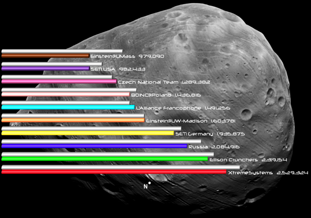

Sam,
I love your new night sky background for the Einstein Stats. Looks cool and very well suited.
