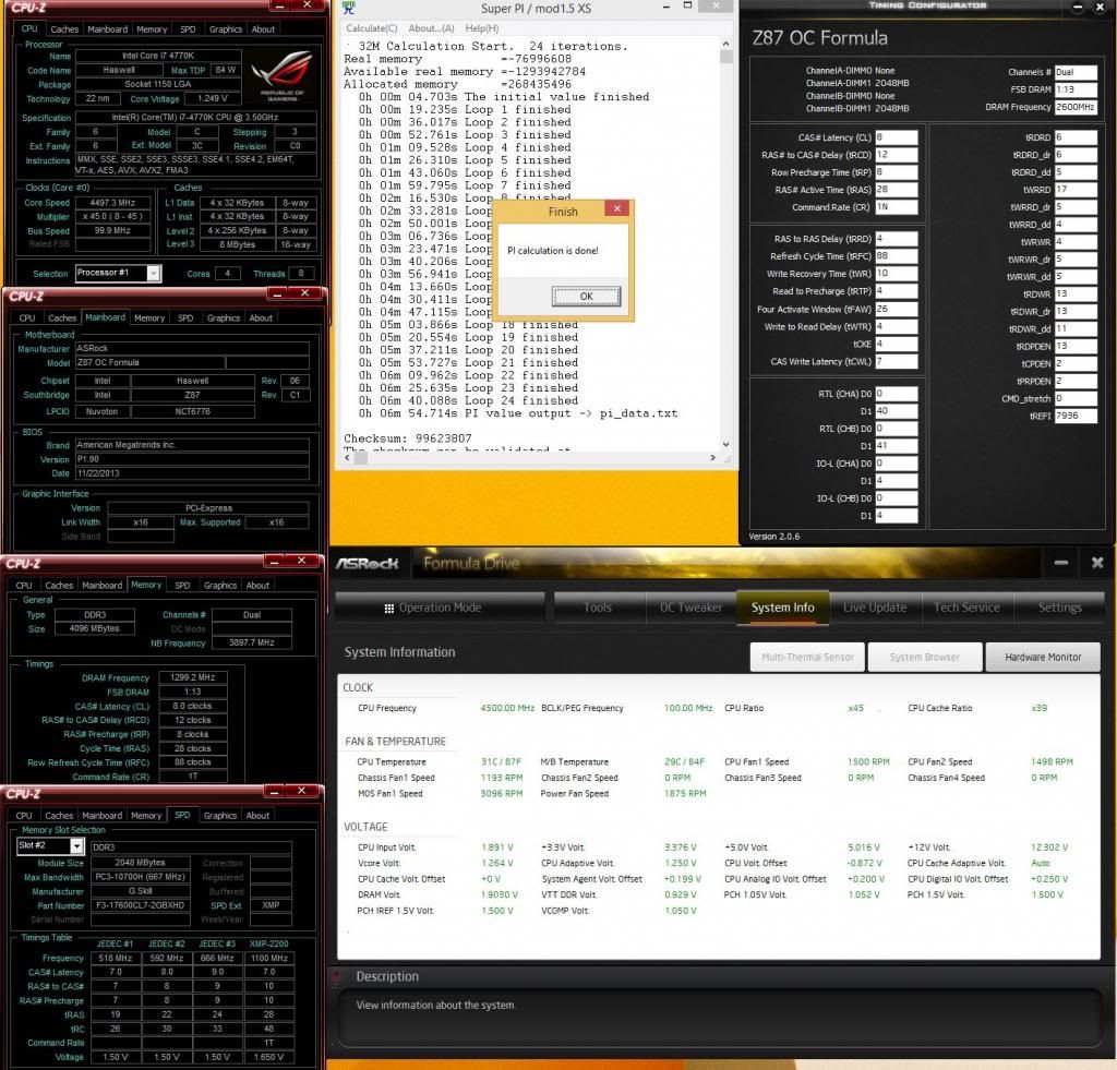

Testing these on Asrock Z87 OC Formula PSC 2600 tight preset.
http://i.imgur.com/EbQ4TVk.jpg
Not bad :up: - your first 1300 on psc? Keep on testing, these seem to do a good job :)
How much farther can I realistically push PSC on air?
Depends on quality and voltage scaling of the mems, 2666 at same timings is realistic goal, on very good mems you might get higher, but this is extremely hard with K cpu and depends also on IMC
Think about imc before you go to bin memories on air i think all* imcs can do 2600 but when you talk about 2750 air so its not easy.
Good psc can do 2700 with thouse timings and 1.85
