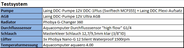

First "complete" review of the HF that I know:
http://www.awardfabrik.de/kuhlung-wa...-hf-plexi.html
Congratulations, Eddy! You got the crown with best performance at more than reasonable flow :up:
(unlike the XT)
The HF did have better flow than XT, but XT beat HF by 0.2C at 3.6ghz setting and lost by 0.2C at 3.2ghz in their test. They are using core temp avgs, which at best have a repeatability of about ~0.2C, so anything less than that is within margin of error. In fact author of study said "The differences between the Apogee and the supreme HF are so small that a clear winner cannot be called."
http://babelfish.yahoo.com/translate...rUrl=Translate
so it is on par with the Swiftech with a lot better flow, so better for multi block loops, after seeing that review instead of getting a new block im thinking my next up-grade will be a pump, as my heatkiller holds its own and does well with a lot of pump behind it
But i do love the internals of the new EK HF block, great work there
