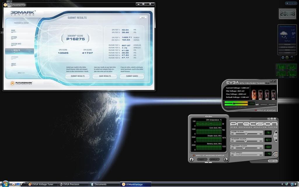

Yes this card is awesome on water. Here is a run I did this morning on a P5Q with a EVGA GTX280 with EK block on its own loop with a GTX240 rad. http://service.futuremark.com/compare?3dm06=9955987 :cool:
WOW, very nice!
Will do those runs later tonight. I did a run earlier at those high clocks and got near 22K... it was 21,97x I think 21,973 but cannot remember the last number.
It's just shy of 22K though. I'm using high BCLK and low multi. 21x Multi on the CPU for a 4.2GHz OC.

Here is another run I just did this time with my Yorky at 4400mhz at 1.45v. Card is on stock voltage. The GTX280 still scales nicely with a faster CPU and is not maxed yet. My 9650 has more left as well. http://service.futuremark.com/compare?3dm06=10004906:cool:

No mem OC yet... shaders holding back core, VRM temps holding back shaders. notice the voltage this was achieved at.
Here is another run I did last night with my GTX280 on its own loop at 795/1272/1660. http://service.futuremark.com/compare?3dm06=10082128
Ok it looks like my eVGA GTX280 SSC is quite good under water. After some preliminary testing, it seems that 783/1674/2484 is the best absolutely 100% stable OC I can achieve, and with only 1.1625 vcore! Stock vcore is 1.1875. This is stable for 4200+ seconds on FurMark 1.6.5 @ 1024x768 with Xtreme Burn mode enabled, 0xMSAA and no post processing. Lack of voltage is holding me back from increasing the shader and core clocks, and VRM temps are holding me back from increasing voltage. If I had a FC block & dedicated loop, I think I would be looking at an 800/1700+ 24/7 FurMark stable card here! Here's the screenshot:
http://img529.imageshack.us/img529/3718/gpu.th.jpg
I can run the core at 792MHz relativly stable, but it would occasionally cause an artifact in FurMark. Only very seldomly, though. I am very anal and like my stuff to be 100% stable. If I could run STOCK vcore here, I have no doubt 792MHz and up would be stable with relative ease. Again, VRM temps are the limiting factor here. Take a look at the screenshot :eek:
