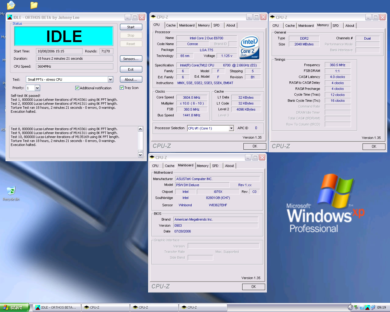

2) With manual timings at 1:1 354, 355, 356 (Wouldn't post past 356), Orthos/Sp/Prime would just freeze my pc. The strangest part is, no sounds, fans, or lights would change, but my mouse would turn off.
I tried using an old mouse and disabling USB legacy, etc, no change.
_______________________
All that said, I'm at 3.33, 1:1, (Stable), 1.4V Bios, Auto on all other voltages. Idle at 28-30, load at 44.

Mine actually run at 4:5 and rig stable at 3.43 ghzQuote:
Originally Posted by Primoz78
Now testing 3.6 ghz Superpi 32 stable , have to run prime
Can you give me the exact BIOS settings you are using?...you have an E6400 as I can see..? I will try to rise the VCORE today to get it stable at 400FSB so I can hold them on 800mhz....:cool:Quote:

Yep I have E6400 and E6700 ( actually running it )
My bios settings if could help you E6700@3.43 ghz
-FSb 343 mhz
-Vcore 1.4375 ( in bios 701 )
-Vdimm 2.2v
-Vfsb, Vich and Vmch auto
-PCI-e 105 mhz
-Path 3 disabled
-Ram throttle auto
-only microcode enabled ( C2T,EIST,Virtualisation all OFF )
-PEg heavier
-Ram settings manual at 858 mhz ( so 4:5 ) if I well remember ( cas 4 /4/3/12
I can now boot at 3.6 ghz ( 360 x 10 )under xp but not prime stable just superpi 32 and good score under aquamark 03 ( 20272 cpu score , I did compare to PcCI2iminal when he benched @3.6 ghz but 1:1 ratio and score about 19000 so I may think that running 4:5 is sweet too :D , P5W is very mem divider sensitive IMO though I met issues at 1:1 lol and others can't run it at 4:5 :confused: )
Could run E6400 at 3.1 ghz ( 375 x 8 ) stable
Think I have to go for WC if I want more and stable :)
But 3.43 ghz is a good deal IMO since I 'm still with air cooling
Hope it helps you :)

I'm currently dual Prime stable at 3.6Ghz (360x10) at 1.4250v (probably 1.38v actual according to PC Probe), specs in sig and stablity pic here
The only thing I've changed is disabling HyperPath 3, RAM throttling and EIST. All other frequencies or voltages besides the vCore. RAM timings are set as 4-4-4-12 which are the rated specs, the timings are NOT currently on SPD.
I tried moving up to 3.8Ghz by increasing the FSB to 380 and raising vCore, but even cranking it up to 1.520v ORTHOS crashes out after a few seconds.
Changing the RAM to SPD, vMCH to 1.6v, vDimm to 2.1v (max RAM is rated for I think) and vFSB to 1.4v made no difference at all. I haven't noticed any increase or decrease in stability from changing ANY other settings other than vCore. Memory is rated for at least 400 FSB so I don't think it's that which is causing the problem.
How can I know when I've hit an FSB wall on the motherboard, if none of the other settings (vMCH, vFSB, etc) seem to make any difference? Am I gonna have to stick this under my Vapo to know how much further it will go?
PC Probe warned me about the load temp when I started ORTHOS - which touched 62 degrees, so I'm reluctant to push the vCore much further on air cooling (Arctic Freezer 7 Pro, with the standard thermal pad attached).
Would appreciate any help anyone could give me....
