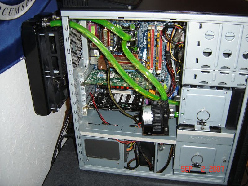

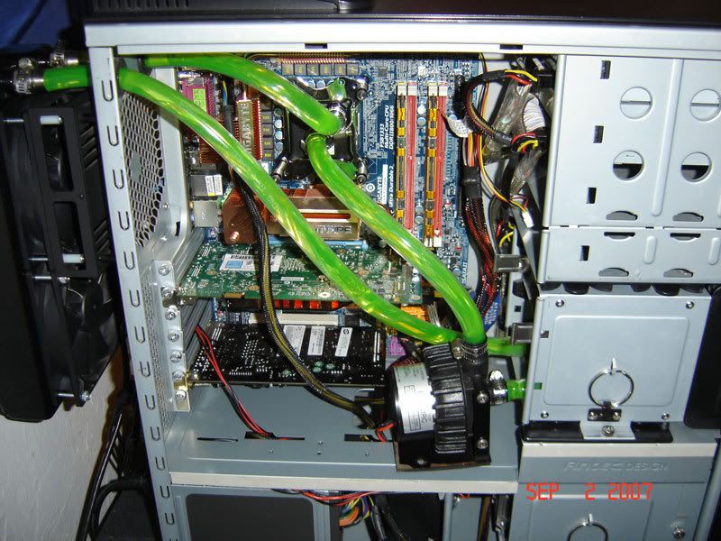

The tubes final destination: A Swiftech Storm Rev2 on an E6600.
http://img522.imageshack.us/img522/3918/img0048fz4.jpg
