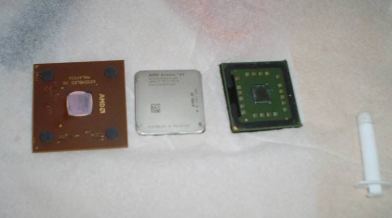

Tried a second time now to remove the IHS.
Damn I cant do it.
I cant find a thin blade to get between the IHS and the cpu.
Yours must have been a thicker layer.
It just pisses me off.
Didt yours come off easily?
take a razor-blade and push it in. dont use it like a saw
But is only the cuttingedge that I can get in between the HS.
The layer is so very thin -about 0,5mm -Is this normal?
yes
People are taking about this as an easy mod.
I would say it is a hard one.
How can you use a thicker blade than what the actually cap is between the HS -I just dont get it. If I push hard -it just give a metallic sound, because I then cut in the heatspreader it self.
Removed the IHS, take your time for that,Quote:
Originally Posted by mbm
a few tips:
(1) Processor pins are fragile, set it in foam.
(2) Use breath-thin razor-blades.
(3) Always work on the top margin of the black silicone.
(4) No saw or cut, very gentle pressing in been sufficient completely. Piece for piece around.
(5) Subsequently, where the gap is in the silicone and the black plastic sign, puts a fine screwdriver on, Up-lever and then again very slowly.
Finaly you are lost from AMD (greenhouse) CASE temp.
Clean the processor core carefully with 99% alcohol.
Now maybe you need to mod your CPU Heatsink, so it make a properly contact with the core!
Use Arctic Silver AS5 ......
