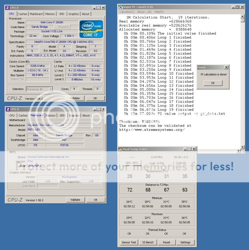

F7d/F7e, x53 mutli is fine only with BCLK 1001 set in bios
http://i967.photobucket.com/albums/a...K_x53Multi.jpg
http://i967.photobucket.com/albums/a...52gC7PI32m.png
http://i967.photobucket.com/albums/a...KMaxmemAir.png
