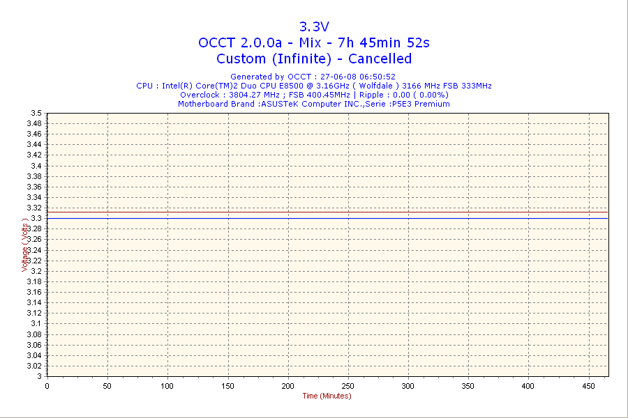

EDIT 3,3V line for Vodoo
http://i30.photobucket.com/albums/c3...6h50-Volt3.png

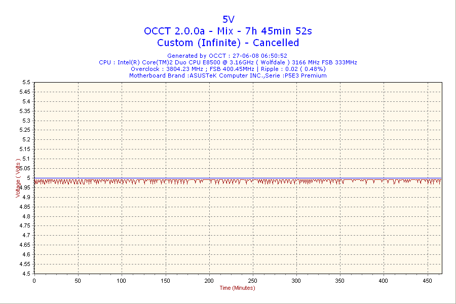

5V a bit shakey...
http://i30.photobucket.com/albums/c3...6h50-Volt5.png
However never trust OCCT or any windows based program for voltage messurements!
