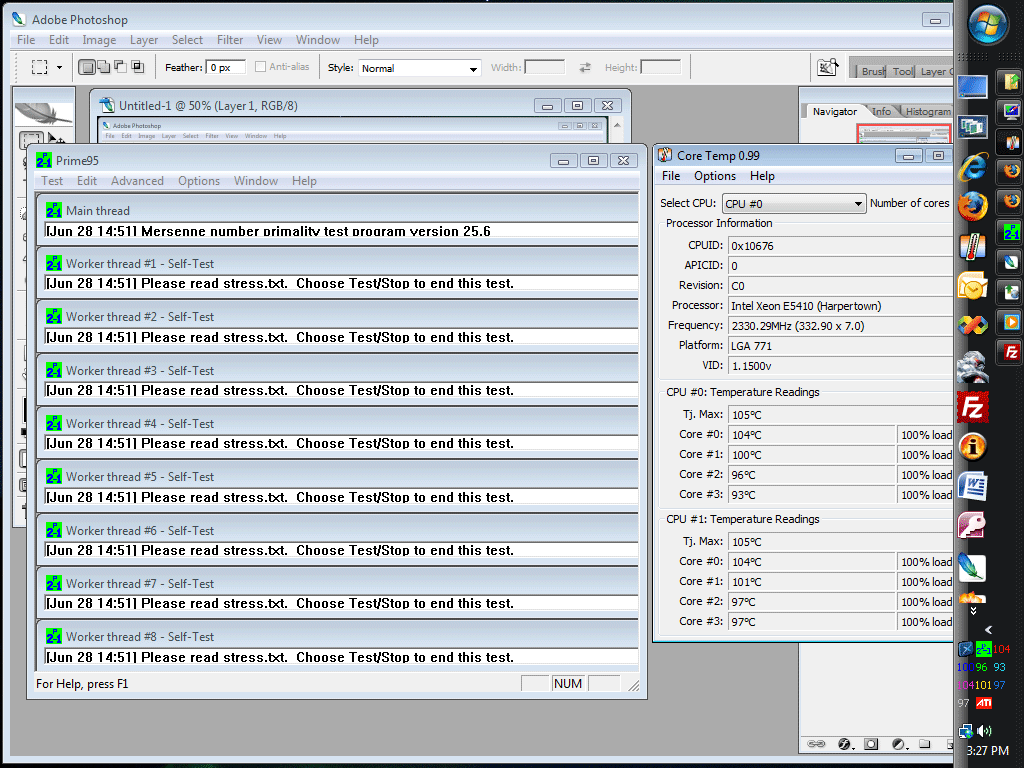

Still running stock but I will try 400 FSB this weekend at some point.
Here is a picture of my heatsink + fan (active) and a pic of the (passive) heatsink.
-snip-
As you can see the passive heatsink is rather larger. Al models from the 5405 to the 5450 come with the option of active or passive, so I think it's a rather well proven point that you don't need to go active cooling. Either way like I said before I'm not trying to cook these by overclocking too much which would in my opinion require better cooling. However, since the heatsink and fan for each model from 5405 - 5450 is identical from Intel, I think I'm set up to 3Ghz.
Part of the reason my heatsink for the cpus aren't warm to the touch is because of the fan directly above them, and the room they are in. Also I'm not feeling them from the top but rather the thick base/bottom (one piece unlike your HR's), and the side fins. There is a 10d temp swing from my upstairs and downstairs, and currently the rig is on a table, in the case with both sides open, a top exhaust fan, front input fan, dual rear exhaust fans so it's getting a lot of airflow downstairs where the cold air shoots out from the ceiling.
