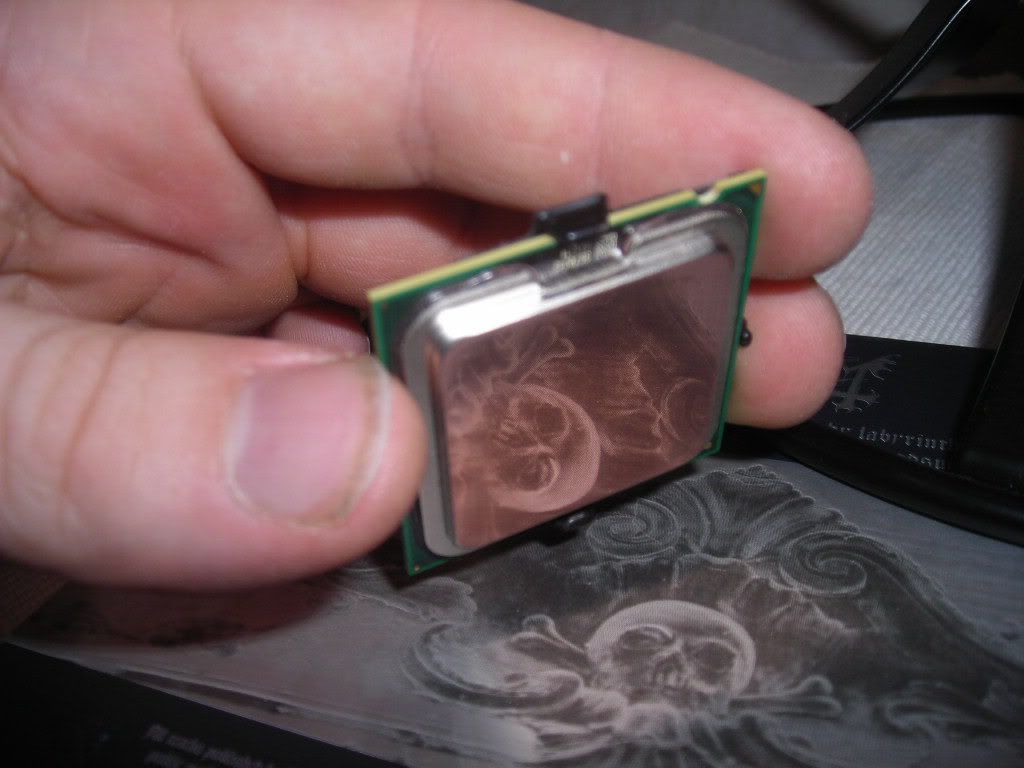

Real nice RockfordFosgate. What improvments have you seen in temps? What were you're temps before lapping and after (idle & load)?
@cool_dude
Thanks.
Before:
Core1:45 Core2:48 @3.6 1.4v idle///Load: 50 53
After:
Core1:44 Core2:45 /// Load:48-48
Your cores idle at 3°C less then load ? mine bump up from 38° to 55°C under load...
I love my apogee GTX :D
1.4v bios-1.35v reel (P5B deluxe vdrop)
Up load temp is not orthos guys @Ortos 51-51 (1.45v bıos 1.4v reel)

Just lapped my QX6700 :)
Before:
http://img244.imageshack.us/img244/8...forelapad2.jpg
After:
http://img240.imageshack.us/img240/6...dpolishct9.jpg
I did the lapping job on my E6600 L626A115, and the temp's decrease about 5c but still the temp's are way to high I don't understand it any more, since I have second E6600 new batch so it work's @1.46v and 3.550 stable, Idle temp's are 32c both core's, and the lapped one I have it on 3.6Ghz and 1.4v and the idle temp's are over 48c and it's really good lapping on it also on my Scythe Infinity, same cooler on both cores, the on with more voltage is much cooler then the other with less.
Anybody any IDEA what else I could do, since I know this cpu would OC very well but not with those high temp's.

This was a great post on lapping :)
It was my first time also on CPU lapping just get enough time and do it slowly and there want be any problem, secure the pin side good so the dust don't get to it and it stays clean.
Good Luck :)
I lapped my U120 Extreme over the weekend. I used knife oil to make it easier and not leave scratches. I used 220, 650, and 1500grit wet dry paper. But it is not a mirror like these. If I start to do it dry it leaves scratches. Do I need higher grit sandpaper or will it finish like a mirror if I just keep doing it? Will it even make a difference between a flat copper finish and a mirror copper finish?
