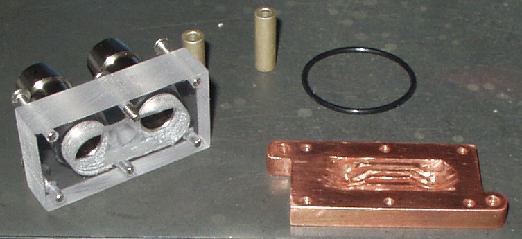

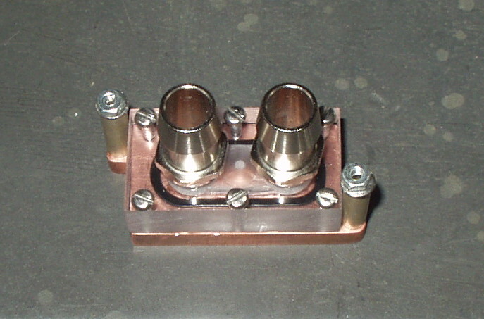

Here's my mosfet block. Only had cheapo drill-press, B&D RTX (dremel), and hack-saw, files, etc.... I just used the stock TIM pad, as the mosfets definitely weren't level with each other. It's at the end of my 2nd loop - 8800GT>SB>NB>PWM. D-tek 1/2" G-1/4" barbs
Keeps PWM at 37c if you can trust the sensors.
http://www.daemonfly.com/images/mozarttx/mosblock1.jpg
http://www.daemonfly.com/images/mozarttx/mosblock2.jpg
It's mounted to #4-40 studs with a 3/16" aluminum back-plate with 1/16" neoprene rubber insulating it.
Just got OS installed, and some stuff set up. Waiting for lines to bleed out (still a few bubbles here & there). Then I'll start OCing.
