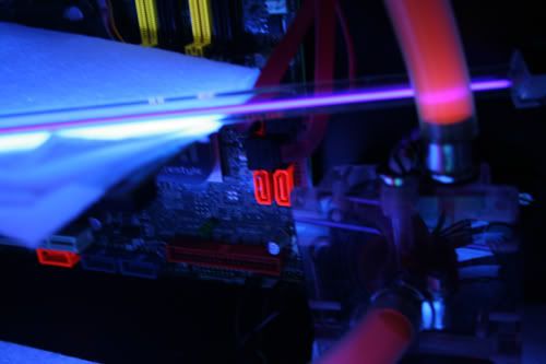

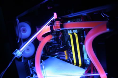

Hey there!
My first post - been browsing the forums for a bit and finally registered!
Here's another Antec 900 as every1 else says...its cramped...also, I wanted to mount everything internally so opted for a Tt rad...bad choice.
I have a Lian-Li V1200 with a PA120.2 on the way soon (I hope!) so watch out for my new one ;)
Only the CPU atm, but hope to extend it to the N/S Bridges and GPU and RAM (eventually - with 2 loops!)
PICS!:
http://i122.photobucket.com/albums/o...DSC00064-1.jpg
With flash - I cut 2 messy holes to wire behind the mobo.
http://i122.photobucket.com/albums/o...DSC00063-1.jpg
in the dark
http://i122.photobucket.com/albums/o...DSC00065-1.jpg
My first attempt. it's OK :)
