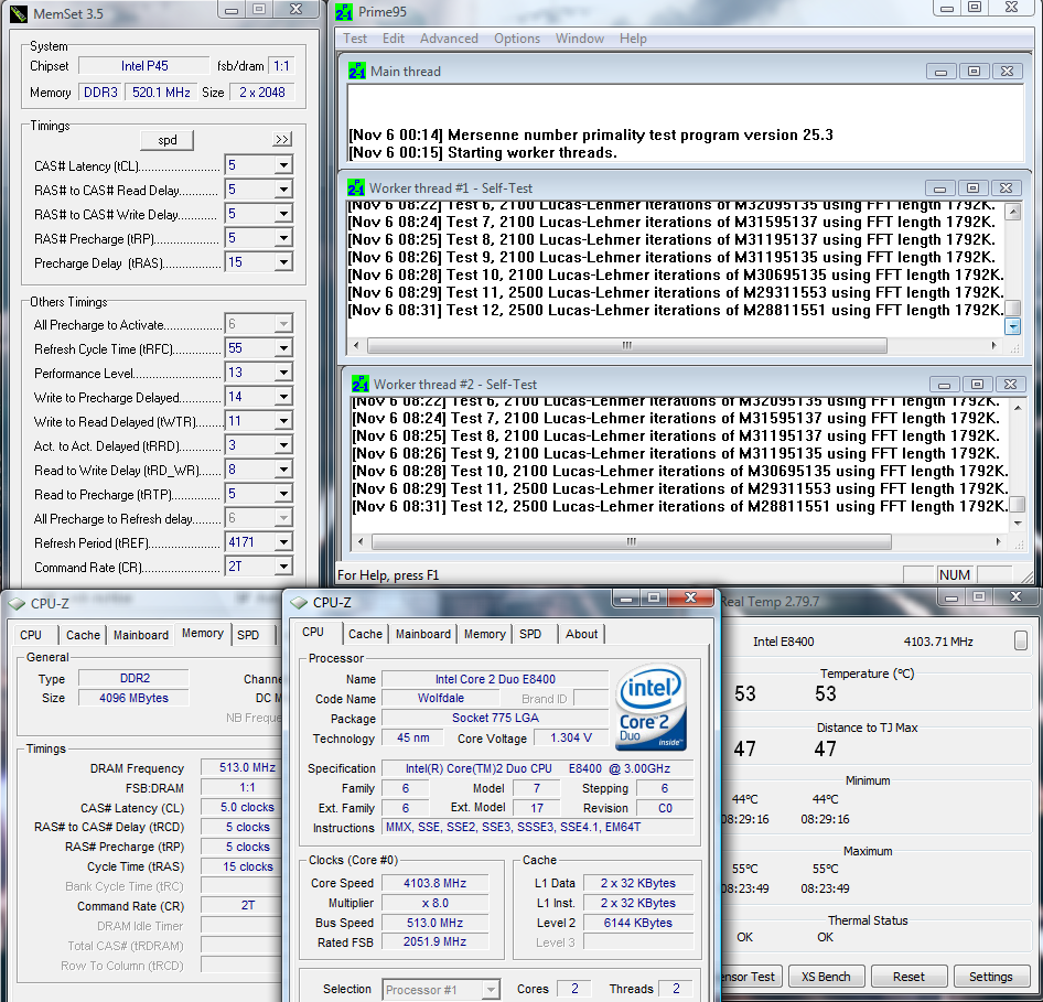

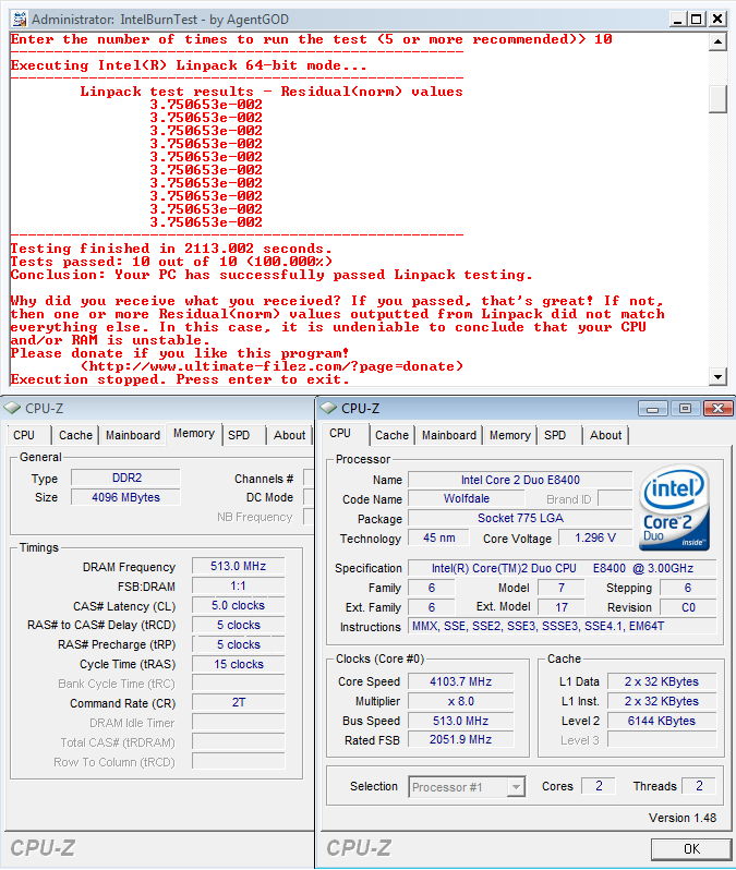

These are my 24/7 settings.
AI Overclock tuner: Manual
CPU Ratio Setting: 8
FSB Strap to North Bridge: 333
FSB Frequency: 480
PCI-E Frequency: 104
DRAM Frequency: 1152
DRAM CLK Skew on Channel A1: AUTO
DRAM CLK Skew on Channel A2: AUTO
DRAM CLK Skew on Channel B1: AUTO
DRAM CLK Skew on Channel B2: AUTO
DRAM Timing Control: Manual
1st Information:
CAS# Latency: 5
DRAM RAS# to CAS# Delay: 5
DRAM RAS# Precharge: 5
DRAM RAS# Activate to Precharge: 15
RAS# to RAS# Delay : AUTO
Row Refresh Cycle Time: Auto
Write Recovery Time: AUTO
Read to Precharge Time: AUTO
2nd Information :
READ to WRITE Delay (S/D): AUTO
Write to Read Delay (S): AUTO
WRITE to READ Delay (D): AUTO
READ to READ Delay (S): AUTO
READ to READ Delay (D): AUTO
WRITE to WRITE Delay (S): AUTO
WRITE to WRITE Delay (D): AUTO
3rd Information :
WRITE to PRE Delay: AUTO
READ to PRE Delay: AUTO
PRE to PRE Delay: AUTO
ALL PRE to ACT Delay: AUTO
ALL PRE to REF Delay: AUTO
DRAM Read Training: Disabled
MEM. OC Charger: Enabled
AI Clock Twister: Stronger
AI Transaction Booster: Manual
PL: 8
All pull ins enabled
CPU Voltage: 1.28 " I had to up this one on BIOS 1406 which I am on now"
CPU GTL Voltage Reference (0/2): .63
CPU GTL Voltage Reference (1/3): .63
CPU PLL Voltage: 1.56
FSB Termination Voltage: 1.22
DRAM Voltage: 2.02
NB Voltage: 1.3 "anything higher and my boards acts funny"
NB GTL Reference: AUTO
SBridge Voltage: 1.2
PCIE SATA Voltage: 1.6
Load Line Calibration: Enabled
CPU Spread Spectrum: Disabled
CPU Clock Skew : AUTO
NB Clock Skew : AUTO
Hope this help you. :up:
