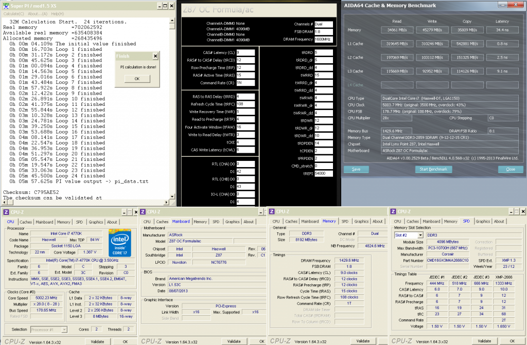

Giving this board a 2nd try for now. Still trying to figure out what it's setting so tight that requires more VDIMM for Super Pi 32M than the Gigabyte at the same clocks and primary timings.
Set the same settings you manually set before, and then compare the secondary and tertiary timings. What kind of vdimm difference are we talking? .05v? .1v? My understanding is that because this board has really good memory training, you might have to set the boot voltage a little higher, but then lower the eventual voltage to what you would like to run.
I've had no issues what-so-ever with my board. Now granted, I'm no memory clocking or 32M super pi guru, but I couldn't get my "bad" kit of PSC to run 2600 for the life of my on my 3770k (which my "good" kit ran easily). But this board takes my "bad" kit to 2600+ on air.
Here's an example. To run my 4x4GB Trident X 2666C11 kit at 2800 12-14-14-35-2T, it only took 1.65v for Super Pi 32M. I only needed 1.695v to do the same speed at C11:
http://i.imgur.com/8cDVfno.jpg
On the OCF, 2800 C12 needed 1.72v set!
http://i.imgur.com/BdiUuCy.jpg
What are the rtls at on each? Try raising the 19-19-19 to 22-22-22
I really want to like this board, so I'm trying to figure out why I can't get it to do what the Gigabyte can. I hooked the OC Force back up so I could show you the RTLs and IO-Ls.
http://i.imgur.com/bHcn6Bg.jpg
I noticed the 32M time is slightly faster on the Formula, but I can't see what in the tertiaries is so tight it would require so much more VDIMM.
