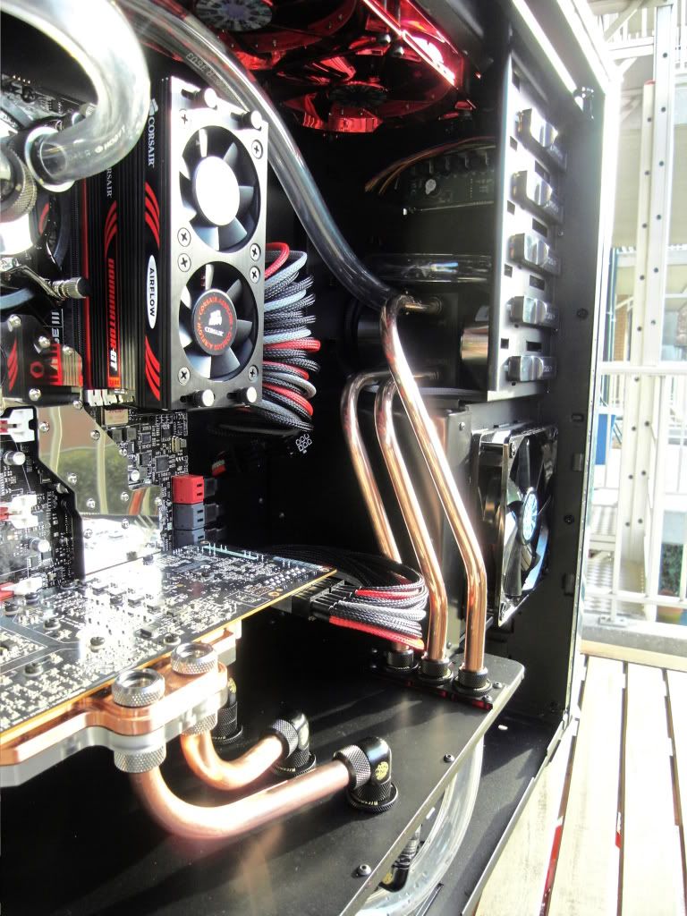

Snelleedie, very nice rig. I like the copper tubing, been wanting to do that myself for some time, but wasn't sure if there would be any issues with leaking. Did you use 1/2" tubing with .035 wall? Also I followed your link to your worklog, really like what you have done, just curious though..when you flushed your rads you had the supply and return going into the same container without a filter inline. Won't this just put the junk from the rad right back into the rad? Check out my video here on how I flushed the rads and how much junk is in them.http://www.youtube.com/user/WestCoas.../2/X9TwhwVlllo
Snelleedie very nice!!!
a question, you have to hand the separator plate measures the environment and what type of plate is?
Thx Lazyman
while i cleaned the radiator there was no filter between i will keep it in mind with my new CM ^^
The plate it self is 1 mm aluminum for the measures i cant give u those.
I have made that case for a friend of mine and its back to his place
Actually those are terminal blocks, you can find them at McMaster Carr. I used them just to reduce some of the clutter, pumps, cold cathodes, LEDs, basicly anything that uses a 12v positive and a ground. You will have to re-wire whatever you attach to them.
Hope this helps
