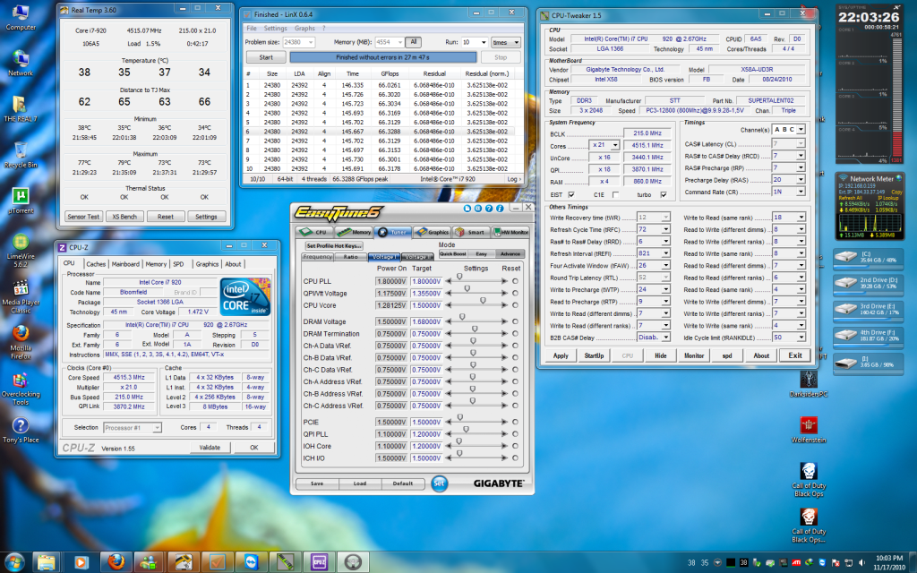

Finally hit 4.5 linx stable . . . had been working on it with Radaja and Sergio few weeks back but kept failing 1 core on ht . . so Sergio said him and a OC nub figured LL2 was the problem , so I turned LL1 on raised vcore to 1.472 and turned Ht off . . . she's rock solid at 4.5 linx and prime :up:
Thanks again Sergio and Radaja and OC nub woot wooooot , guys who are ready to push the limits all the time
http://i84.photobucket.com/albums/k7...nxpassat45.png

Thanks OC Nub so far no problems with the great template U and sergio came up with stable and damn fast :shocked: . . . just thinking maybe I can achieve a bit lower voltage on load with LinX goes from 1.472 to 1.456 fluxing but still way stable , on my board the 2.0 i cant pick a vtt of 1.34
so I just stuck with 1.355
NP, glad it helped. The vtt of 1.335-1.355 is the chip not the board. One of my 920's allows 1.355 and not 1.34, the other visa versa on the same ud7.
