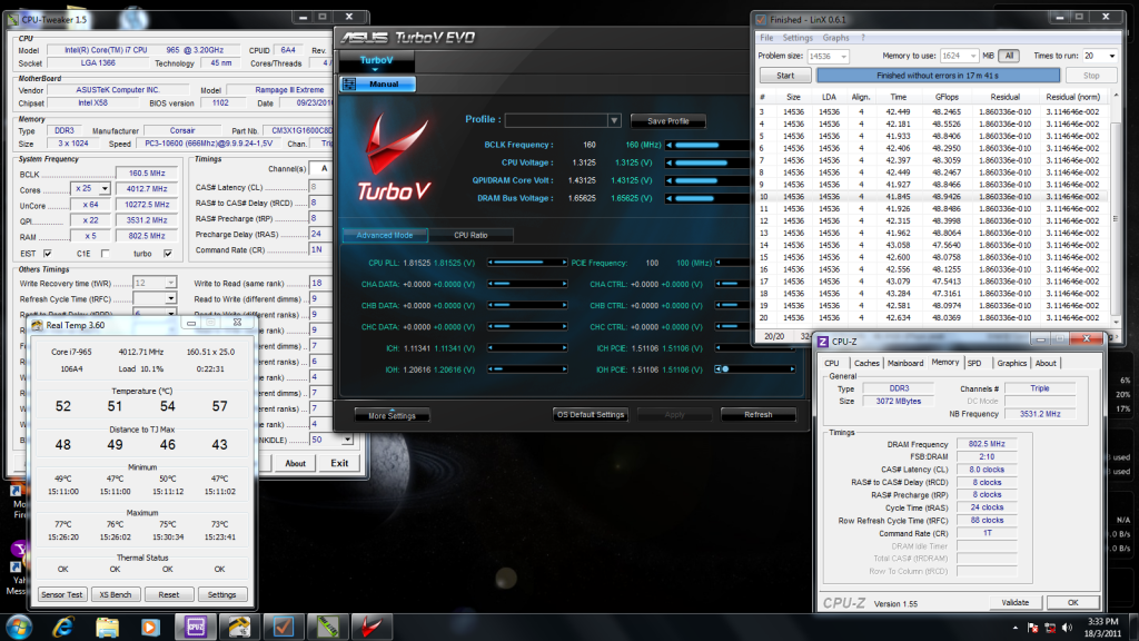

i still didn't manage to get a stable linx test..
it drops on the 14, 17 and 18th test...
http://i645.photobucket.com/albums/u...ka_189/oc1.png
this is my bios template..(1102)
is there anything that i've overlooked here..?Code:Target CPU Frequency 4000MHz

That looks good, I wouldn't worry about it dropping fractions of a gflop here and there, could be background process related as is not IMO demonstrative of an issue.
Yeah looks like it, with mine it doesn't detect the core multi/freq properly. I just use CPU-Z
