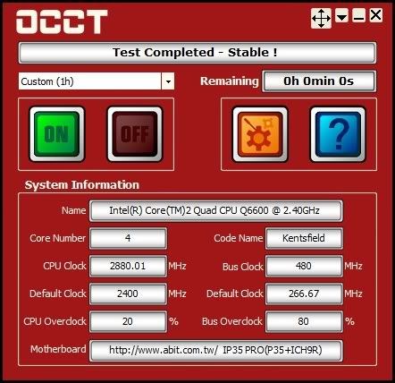

I managed 480 FSB on my G0 Q6600 (L737B) using my IP35 Pro. I think it had more to go but the IP35 Pro just couldn't handle it. I just picked up a Maximus so hopefully it can do at least the same if not better.
http://i61.photobucket.com/albums/h5...B--OCCT1hr.jpg
