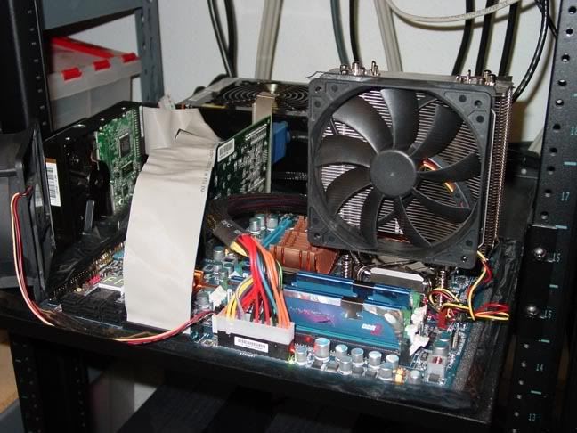

On a side note, I've taken to DDT's scheme on machines. Here is Farm-09 on a rack mount tray. MUCH easier to work on this way. I doubt I'll be using rack cases anymore. I may as well "go industrial"...:yepp:
http://i149.photobucket.com/albums/s...9traymount.jpg
