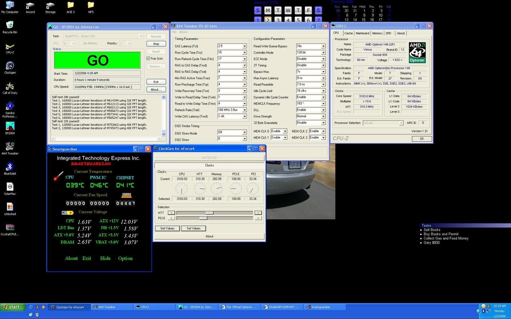

Here's mine... tweaked two days to get 3.1GHz
http://img.photobucket.com/albums/v3...blueeboi/3.jpg

Here is some SP2004 action
http://img277.imageshack.us/img277/8...p20043h3vy.jpg
