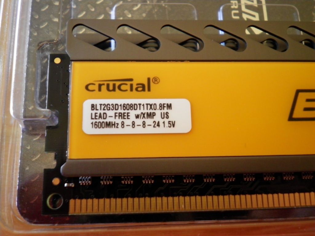

Sadly I have an extremely limited budget when it comes to benching hardware. But I recently managed to grab a super cheap 2x2GB Crucial Ballistix kit (BLT2CP2G3D1608DT1TX0CEU)
(http://www.crucial.com/eu/store/part...D1608DT1TX0CEU) and I was wondering if anyone had any idea on what ICs it might use.
Here is a quick picture:
http://i1196.photobucket.com/albums/...ian/hgfgfh.jpg
I haven't dared removing the heatspreaders on the sticks yet though but I hope it might be possible to figure out anyways.

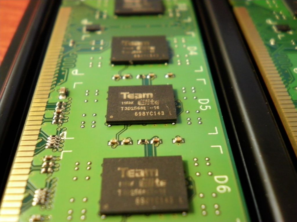

I'm also curious if someone could help identify the ICs on the kit I used in my last benching session. Probably the worst kit I've ever used and I'd advice anyone to stay far away from it.
I originally bought the kit for a LAN-computer and not for benching, but it was sadly the only spare kit I had. When I bought the kit it was the cheapest 8GB kit available in Sweden and it probably still is.
The kit is called "TED38192M1600HC11DC 4GBx2" and the DIMMs are called "TED34096M1600HC11". It's a Team Group Elite 8GB 1600MHz CL11 kit.
Here is a picture of the ICs:
http://i1196.photobucket.com/albums/...ian/fgdgfd.jpg
Sorry for the huge pictures by the way!

As far as I know Memtest can't identify ICs, it just reads the SPD info.
Are the memory sticks single sided? What can your kit do? Crucial is probably using Micron D9PFJ chips on this kit, just like on many other kits that are currently available.
This kit is hard to guess, I think all of the markings on the chip have been made by TeamGroup, and none of the original markings are left. What can this kit do?Quote:
