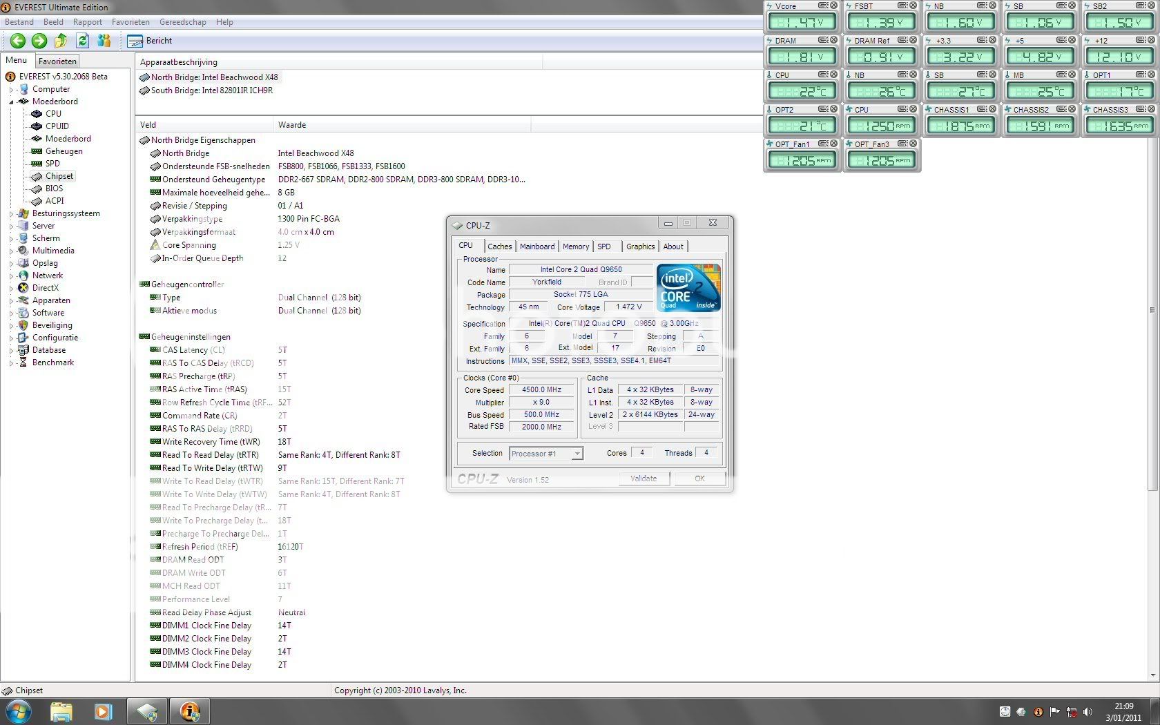

http://i431.photobucket.com/albums/q...ReadODT11T.jpg
This is with MCH Read ODT 11T. The hardest part is to boot and have it load BAR_Edit so it doesn't BSOD because of the low voltage. :rofl:

With MCH Read ODT 11T the board seems to be a lot more stable. Without the 11T it would BSOD very quick and it would be impossible to load anything so it wouldn't be possible to make a screenshot at 4.5GHz with such low FSB Termination Voltage and NB Voltage.
To find stability I need 11T because with 8T I think I need more voltage and more voltage on the NB than necessary makes it unstable with the amount of clock skew that I'm using.
@SoLoR
Can you mod the BIOS and change MCH Read ODT from 8T to 11T to give it a try and see if it's holding us from the higher clocks?
It doesn't matter that it would always be at 11T because it is stable with my 24/7 overclock and it doesn't lower the performance.
