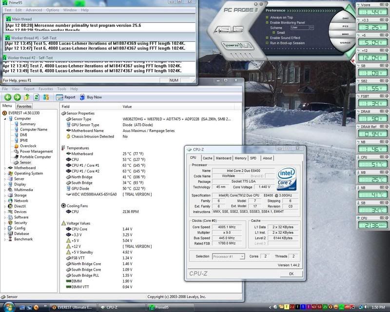

I just downloaded the Trial Ver of Everest and started to prime again using Blend. CPU temp result is very close between Probe and Everest, actually almost all the readings are close to each other. Not sure about Core 1 and Core 2 temp though, why are they higher than the actual CPU temp on Everest?

1004 temps seem to be reporting correctly, or they did for me anyways, It could be your bios giving you grief, you seem to banging your head alot on a few issues with the 9?? series bios.
core temps are always higher, this is normal

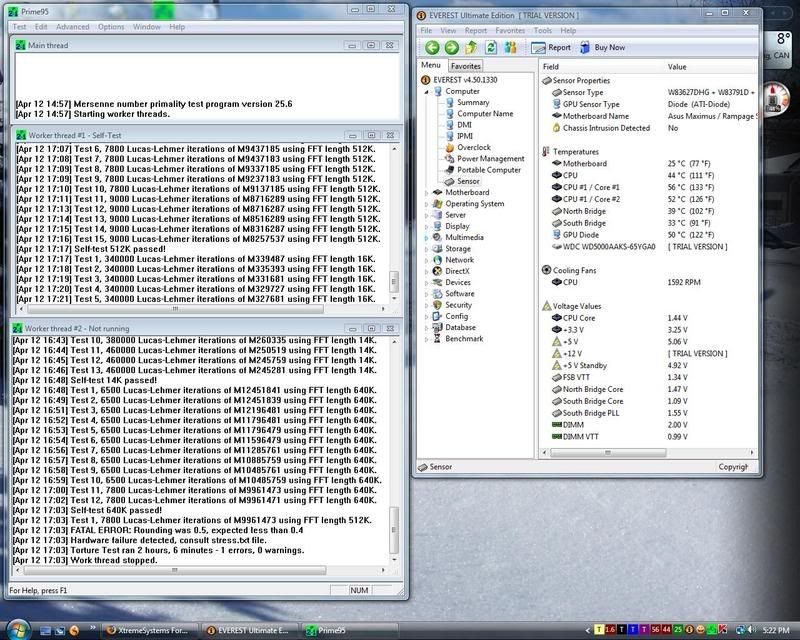

Ok guys, I need help and suggestions here, today I ran prime95 at small FFTs settings for more than 5 hours with no errors. Then i switched to Blend settings and it primed for 2 hrs and 5 min until i get this error below on worker thread #2!
Any suggestion on my settings below are very much appreciated! Thanks...
http://img.photobucket.com/albums/v708/rcjian/pic4.jpg
Extreme Tweaker
Ai Overclock Tuner : Manual
OC From CPU Level Up : AUTO
CPU Ratio Control : AUTO
- Ratio CMOS Setting : 9
FSB Frequency : 445
PCI-E Frequency: 100
DRAM Frequency: DDR2- 891
DRAM Command Rate : 2T
DRAM Timing Control: Manual
CAS# Latency : 5
RAS# to CAS# Delay : 4
RAS# Precharge : 4
RAS# ActivateTime : 12
RAS# to RAS# Delay : 4
Row Refresh Cycle Time : 50
Write Recovery Time : 5
Read to Precharge Time : 3
Read to Write Delay (S/D) : 9
Write to Read Delay (S) : 5
Write to Read Delay (D) : 5
Read to Read Delay (S) : 4
Read to Read Delay (D) : 6
Write to Write Delay (S) : 4
Write to Write Delay (D) : 6
( enabled will give better bandwidth but might create instability in ram)
Ai Clock Twister : Strong
Transaction Booster : Disabled
Relax level: 0
CPU Voltage : 1.4625(showing 1.44-everest)
CPU PLL Voltage : AUTO
North Bridge Voltage : 1.43(showing 1.47-everest)
DRAM Voltage : 1.9
FSB Termination Voltage : 1.40
South Bridge Voltage : 1.050
Loadline Calibration : Enabled
CPU GTL Reference : 0.63X
North Bridge GTL Reference : 0.67X
DDR2 Controller REF Voltage : DDR2-REFF
SB 1.5V Voltage : 1.5

Prime small fft = stress on CPU primarily
Prime blend = more stress on the NB/Ram than CPU.
Try raising your NB Core, Vdimm(Ram volt) and a relaxed timings. Don't adjust all of the above in the same time. I'd suggest try NB core volt first since you're already good for ~2 hr blend.
With 4GB I agree more NB juice 1.53-1.55 to start
I'm getting rounding errors in prime95 at 2 hours, 2 hours 45 mins, etc with NB voltage of 1.61 (bios = everest).
I would try increasing the relax to [1] or [2] and definitely your RAM volts.
