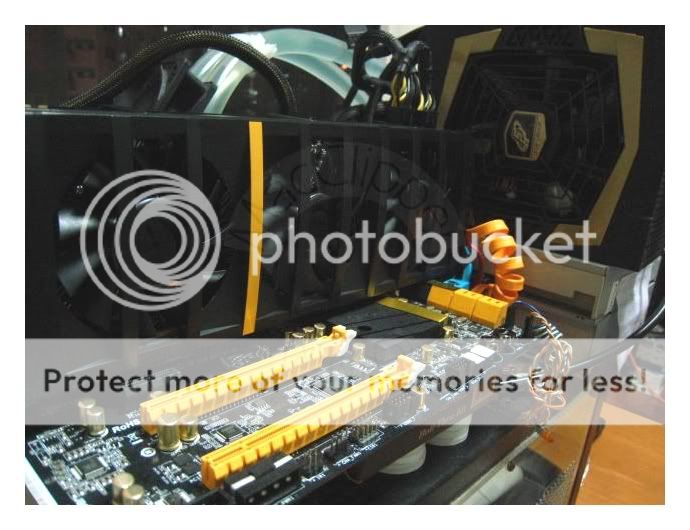

Man, you really out-yellow my test rig... for now. So here comes my Daiso yellow electrical tape, stick stick stick... :D
