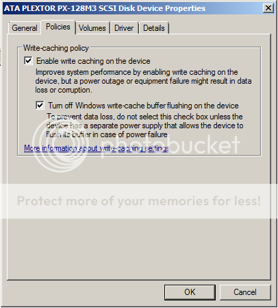

Use windows for the striping, and just use the controller as an HBA. Like the other guy said. Looks like you do not use the IBM as an OS drive, so you do not need to raid it with the controller for booting.
http://i413.photobucket.com/albums/p...xtoprflush.png

I have enable write caching checked off already... care to elaborate? what about the second setting for turn off windows write-cache buffer flushing on the device ?
Look >here<.
that needs to be checked off too then you can enable write caching in irst control panel. look for example here are 2 sandforce drives with write caching enabled
http://i876.photobucket.com/albums/a...liar/050-7.png
notice the 4k performance? yours will be similar when write caching is enabled
