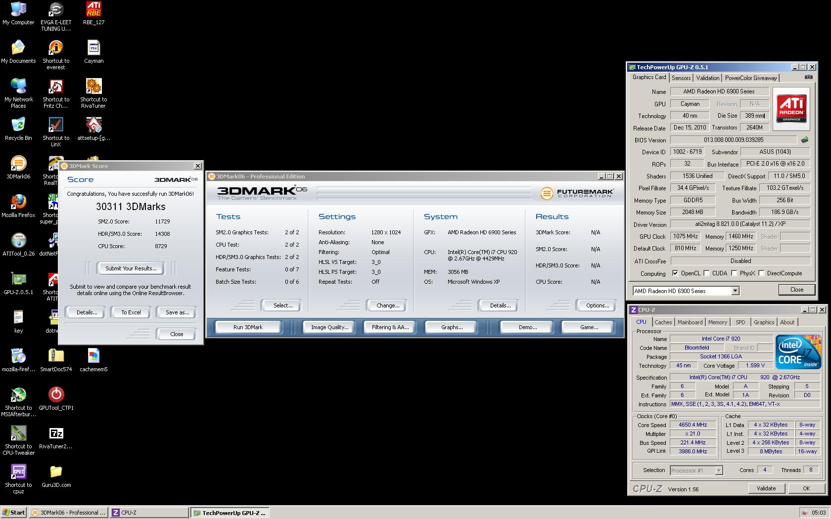

Your temps are good try for more. Here is my max overclock for 3D Mark 06(unlocked 6950 with stock cooling at 100%).
http://store.picbg.net/pubpic/FB/B0/...c4c22dfbb0.JPG
Pretty damn good GPU,what voltage are you using?So far i got 1050 for vantage and 1060 for 2003,maybe 2006 ill squeeze something more :D
1.35 or 1.4v cant remember :D.
Nice on air cooling :up:
Wich brand?
