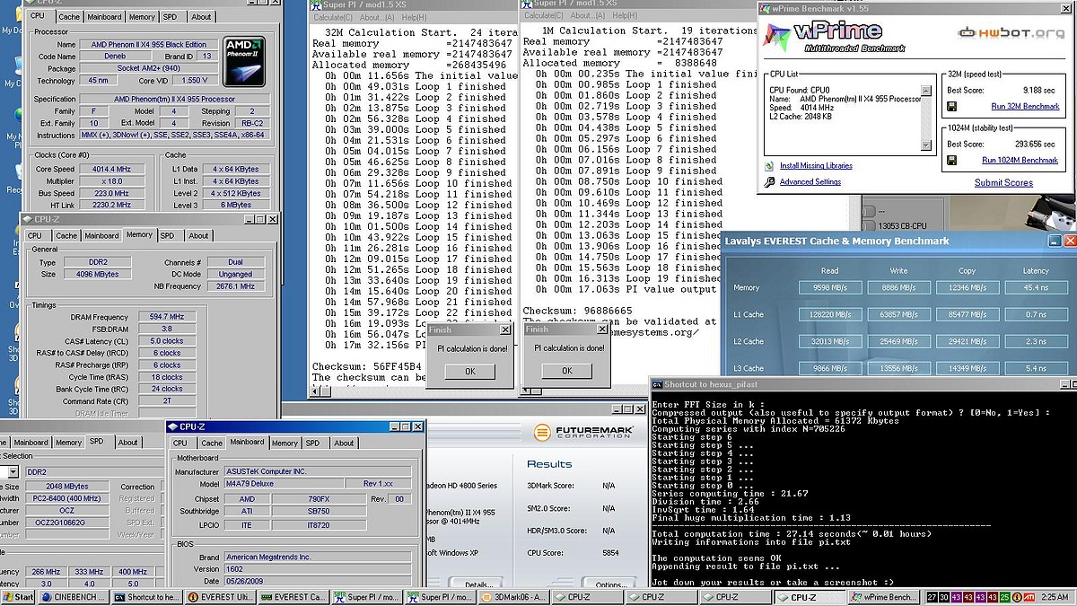

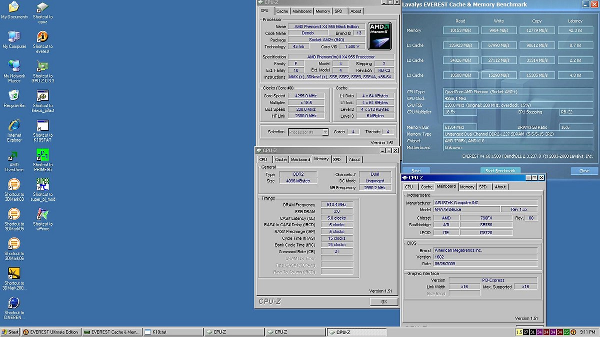

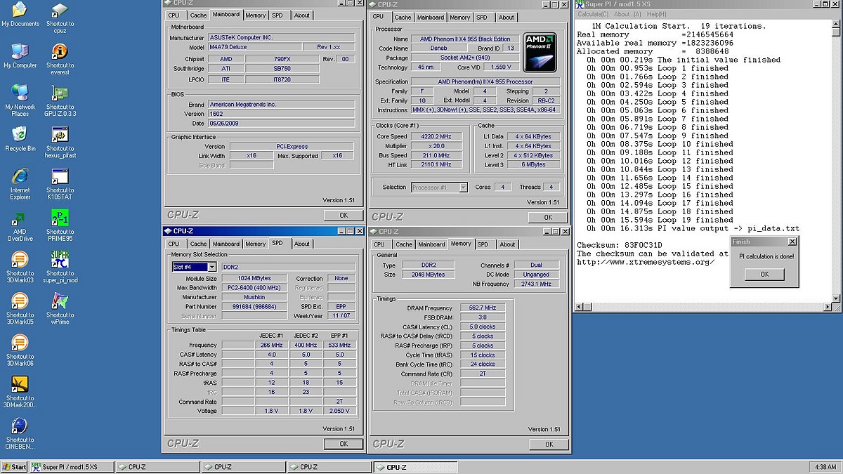

board is on the bench and running now guys.....Gonna toss a few sets of ram at it.....initial impressions is I lost a little cpu wise, gained a little ram wise..gonna try with NB up next.
http://chew.ln2cooling.com/qdig-file...20II/lrg_1.JPG
What vdimm are ure running for 600mhz and how is the Nbvolts treating da 955 ..
Just curiouse ,,
since you dont have the Nb cranked yet ,,
The 1200mhz + on the Ram already has the numbers up vs using 800mhz. Looks good.
Air? You just seeing what it likes to eat for a snack. 1.55v:D
Nah this board has droop chip likes 1.525 so compensating. 2.1 volts for ram....I just nailed a sick 1m for air :D so close to 15's its not funny, this chip has a weak NB though :(
Boards still flaky as far a cpu clocking goes though....inconsistent, one minute it fine next minute it wont even boot.......

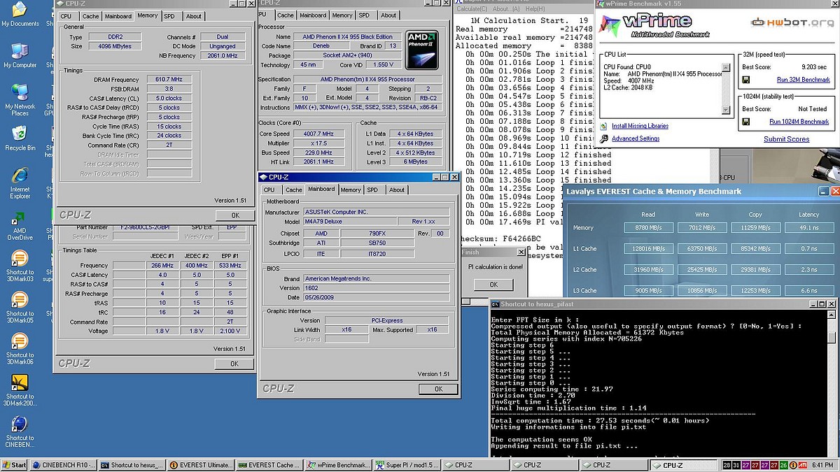

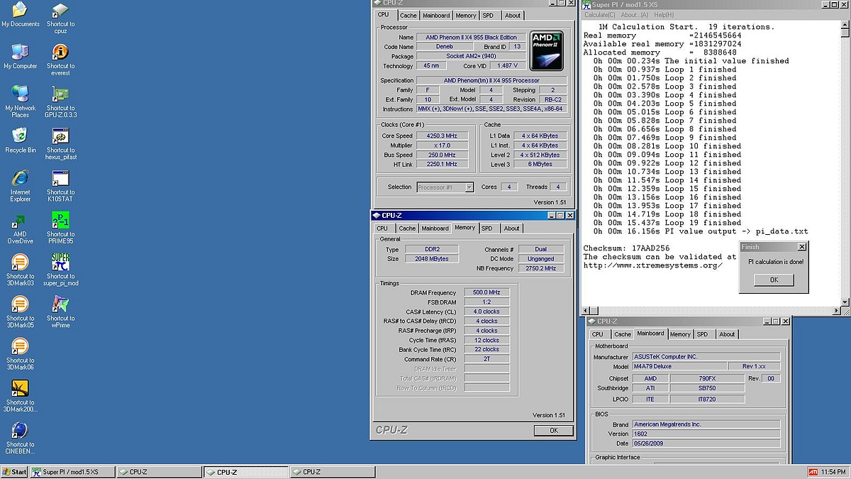

http://chew.ln2cooling.com/qdig-file...20II/lrg_2.JPG

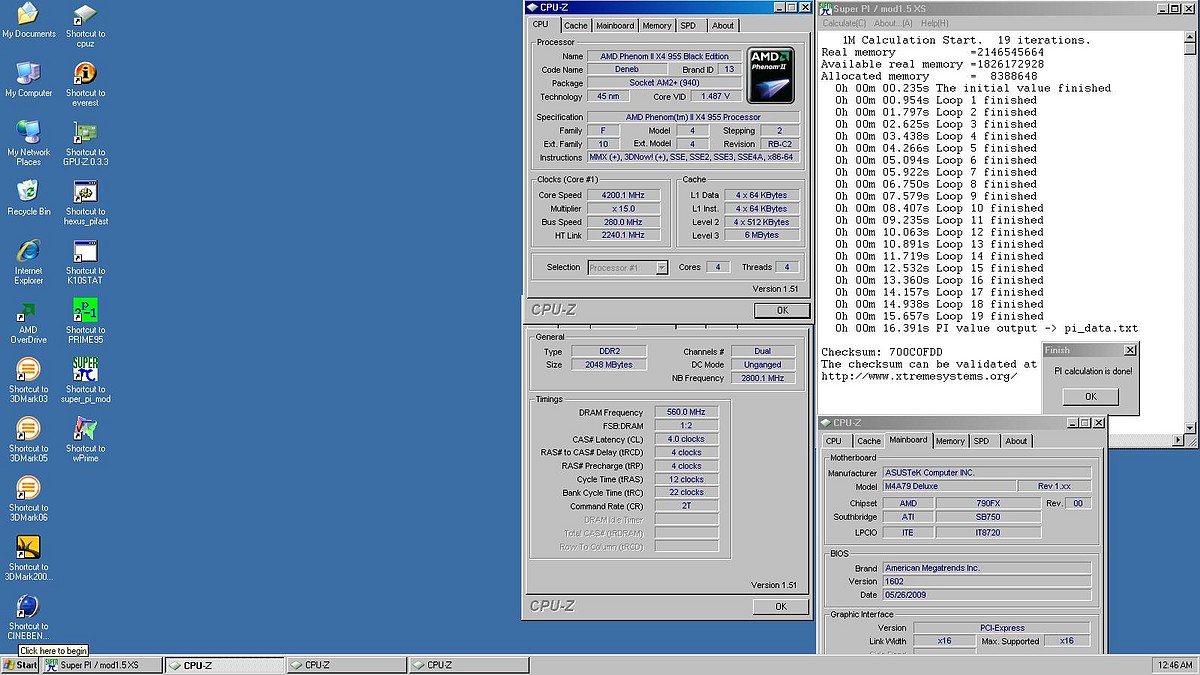

http://chew.ln2cooling.com/qdig-file...20II/lrg_3.JPG
Ehh some more stuff....
This one is stable for the most part Wprime is still giving me a hard time....Usualy can not boot above 1.525 with this chip......It takes 1.5875 to do this on this board and boots......:shrug:

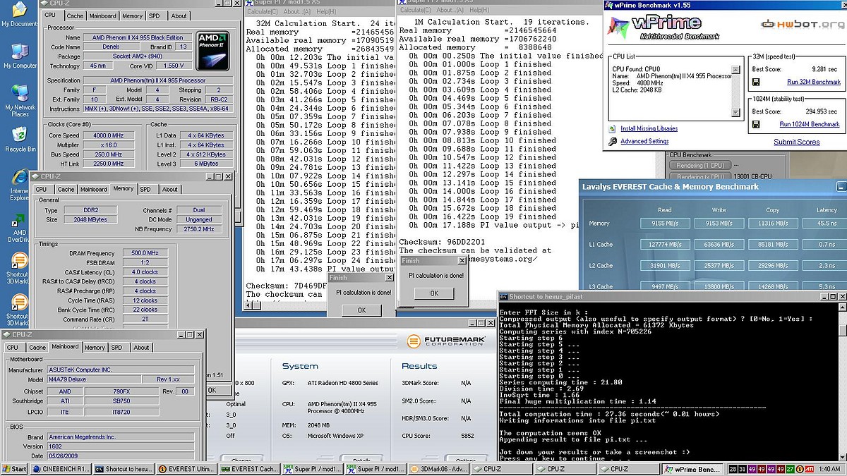

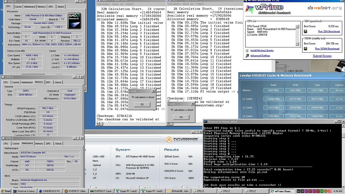

http://chew.ln2cooling.com/qdig-file...20II/lrg_7.JPG
Then I just played around a little bit......gonna toss the cellshocks in next as I had major isues with them on this board prior ( would not pull rated and sticks are not to blame )

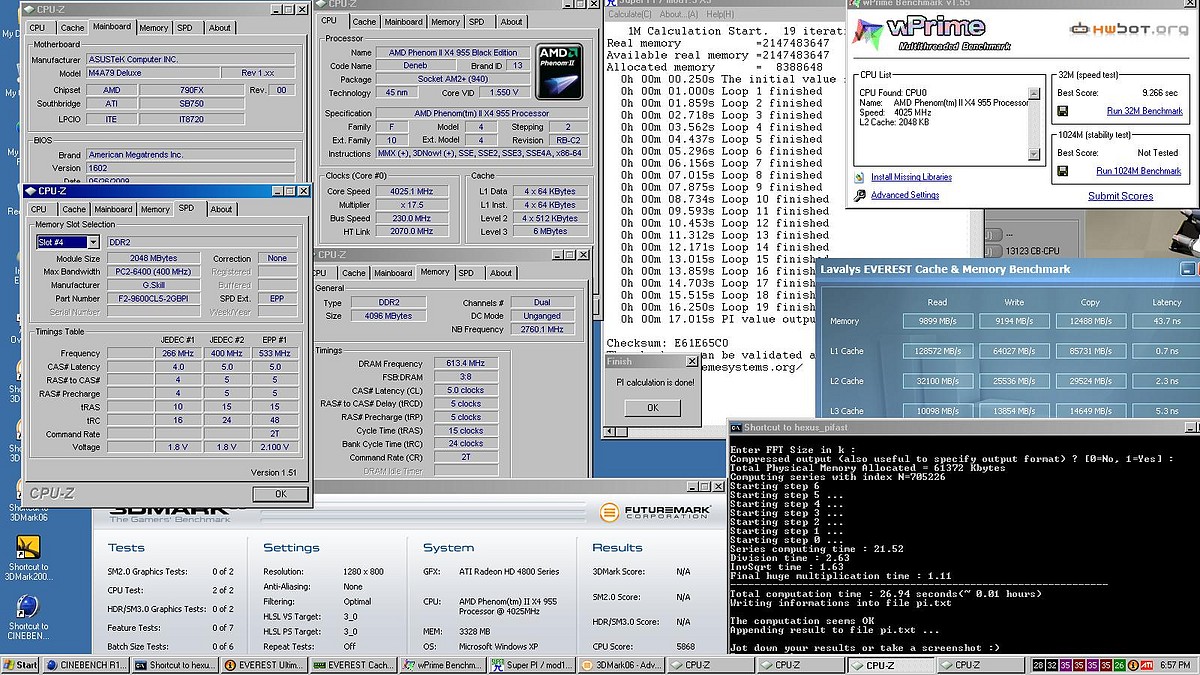

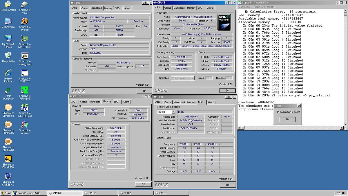

http://chew.ln2cooling.com/qdig-file...20II/lrg_4.JPG
http://chew.ln2cooling.com/qdig-file...20II/lrg_5.JPG
http://chew.ln2cooling.com/qdig-file...20II/lrg_6.JPG
OK now things are getting interesting.......I'm starting to actually like this board again.....If asus can get it more consistent...this board will be a sure contender again.....
My cellshocks actually work now.......rated volts.....rated timings...no tweaking ram settings.....

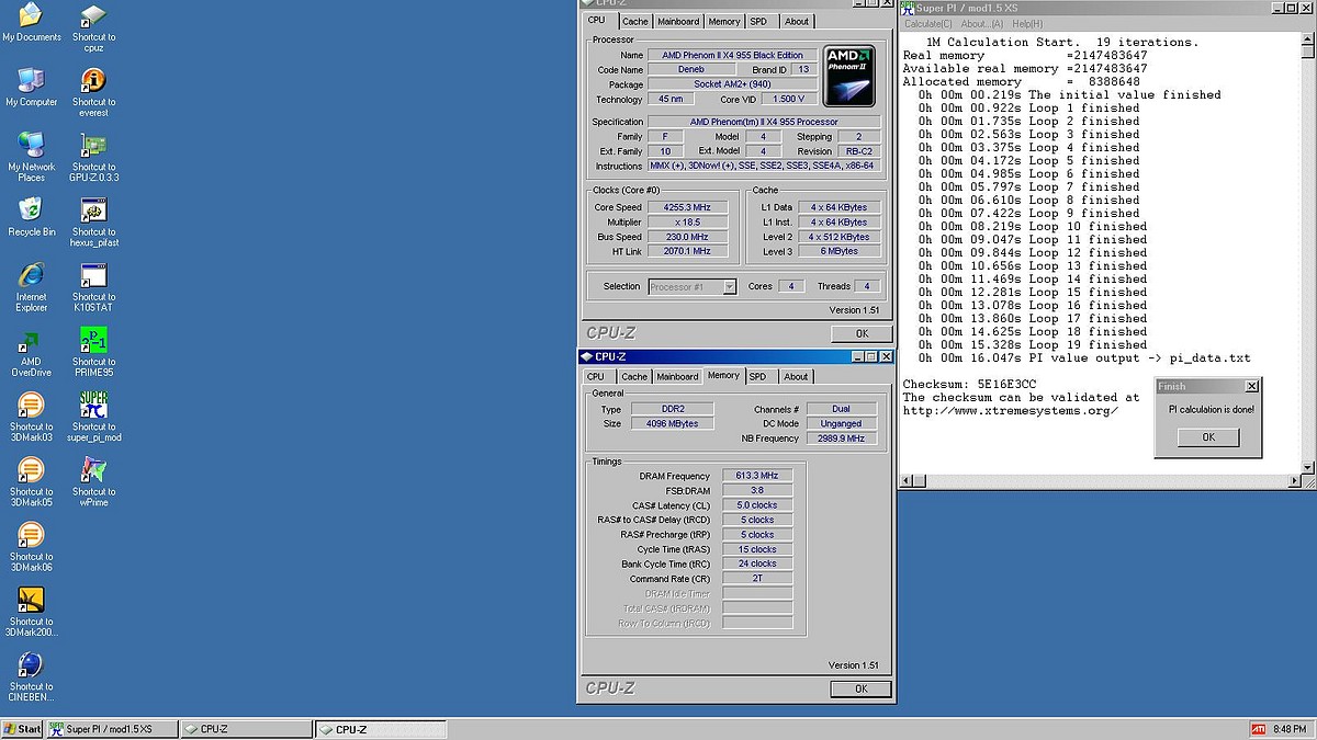

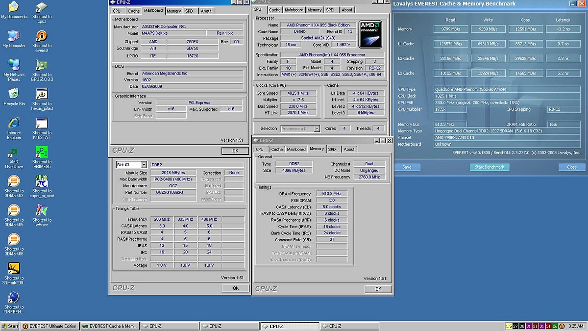

http://chew.ln2cooling.com/qdig-file...20II/lrg_8.JPG
overvolted .1 still easy mode.....rated timings no tweaking :shocked:
http://chew.ln2cooling.com/qdig-file...20II/lrg_9.JPG
This wraps up cellshock testing.....
http://chew.ln2cooling.com/qdig-file...0II/lrg_10.JPG
Seems to be pretty solid for DDR2.

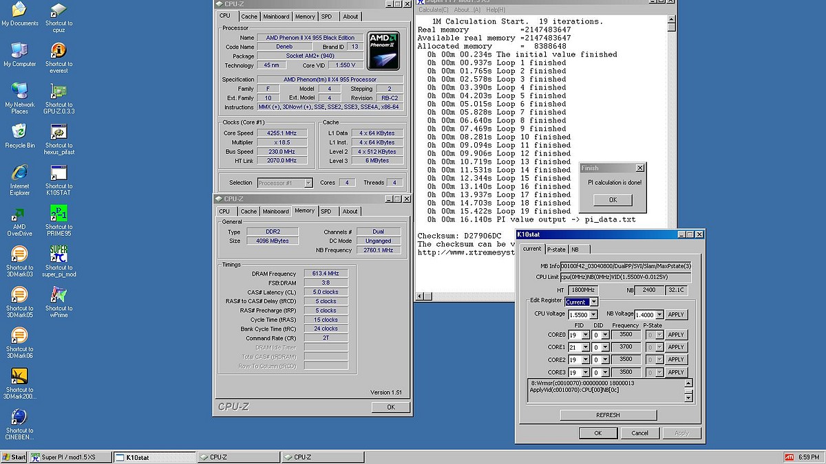

http://chew.ln2cooling.com/qdig-file...0II/lrg_11.JPG
http://chew.ln2cooling.com/qdig-file...0II/lrg_12.JPG
Couldn't get the NB to play nice over 3000 or I would have had sub 16's :(

That would most likely be the NB speeds........In the first round of benches they were near default speeds.
Make sure the board did not drop it down to stock.........This board and the ddr III board both have a bug where when pushed hard they will drop your NB clock down to stock.......The fix is to drop the nb down a notch, reboot then bring it back up and reboot....
Really annoying bug, not as bad as the ddr III board though, that drops vcore settings to when it feels like it also.......
