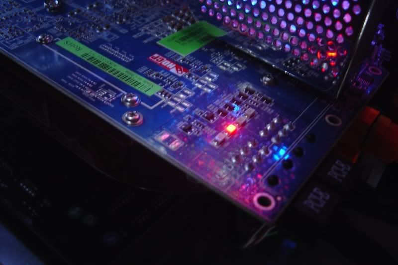

I tried 830/4200 with 40% but furmark crashes after 20seconds or less :clap: i show 150º on VRM :ROTF: and a red led appeared on the card, i rebooted but it didnt turn off :confused:
http://i20.photobucket.com/albums/b2...D/Dsc09443.jpg

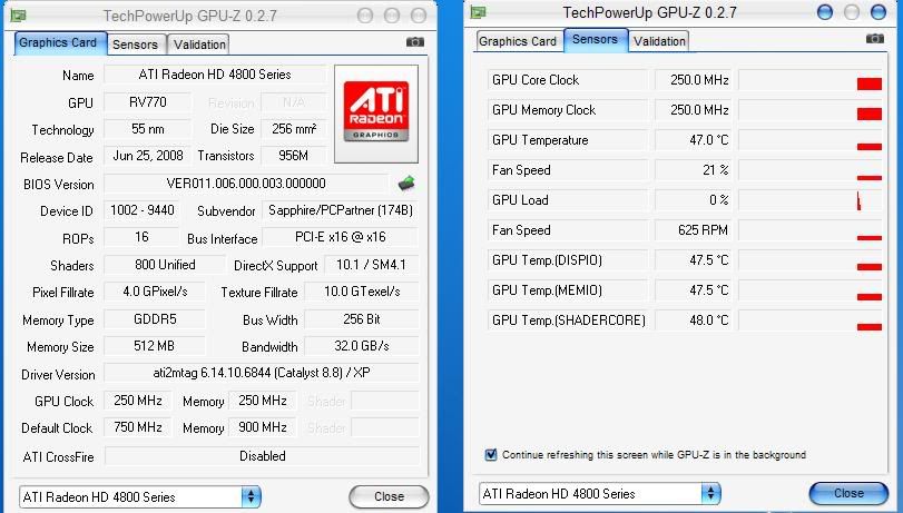

idle temps @ 250/1000 @ 20%:
http://i20.photobucket.com/albums/b2.../Dibujo-70.jpg
EDIT: with stock speeds @ 40% i show 140º easily :p: furmark crashes after 1 minute and the red led appeared again (it only turn off when i power off the PC )

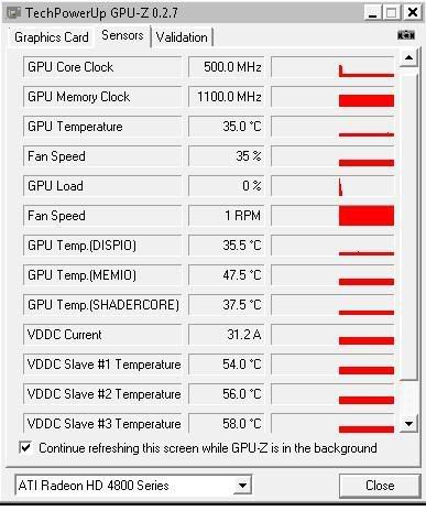

http://i71.photobucket.com/albums/i1...an85/temps.jpg
GPU was idle here, and clocks were 795/1100. I will do a run with furmark 100% load and upload my screenshot here. I was monitoring remotely via RDP from work, so I couldn't run any 3D tests at the time, as a limitation to RDP.
GPU is under an EK 4870 full cover block.
