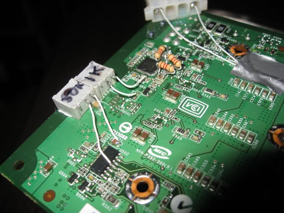

i've made today some mods on my BFG GTS...
vgpu, ocp, cap mods + measure points
can't wait for some subzero action with :D
but at first i'm going to test it on air...

Those "BL 121" chokes really get warm when clocks and vGPU are raised - I'm looking at 82ºC measured from the side of one of those buggers. Mosfet heatsink only reaches 65ºC so it really is the coils that are scorching down there.
So, do you think it's advisable to throw some sinks on the chokes as well?

This first picture on the first post was to do the vmod and vmem mod
I kinda understand
but what is the mod in the second picture?
using that 4 pins plug ?
is it just for connecting the 2 points or do I also have to plug it ?
what is it for ?
http://img.photobucket.com/albums/v3...GTS-vMods2.jpg[/QUOTE]
That 4 pin molex is just for measuring Vmem and Vgpu, you don't really need it, it's just for convenience. :)
