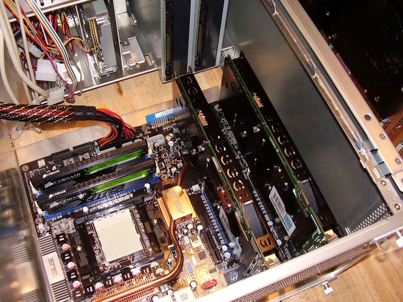

Other pics:

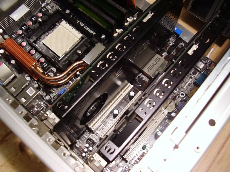

Picked up an A8N32-SLI (Rev 1.01) and installed it this weekend in my watercooled setup...
Bios 1009 and warm boot issues immediately even with the bios all set at defaults... I have yet to get the system up and running properly, though I have noticed it's quiet ;)
I know that newer bioses don't actually fix this problem but I'm wondering if any of you found more stability or better OCing with any of the newer bioses?

http://jupiter.walagata.com/thumbnai...FFFF&text=&t=1
here's a pic of the Danger den nv-78 rev 1.1 water blocks and my Xfi in the middle.
:slobber: :slobber: :slobber: safan :)
How's the sli??? I'm waiting for more paychecks, but would love to know how's she do'in ;)
