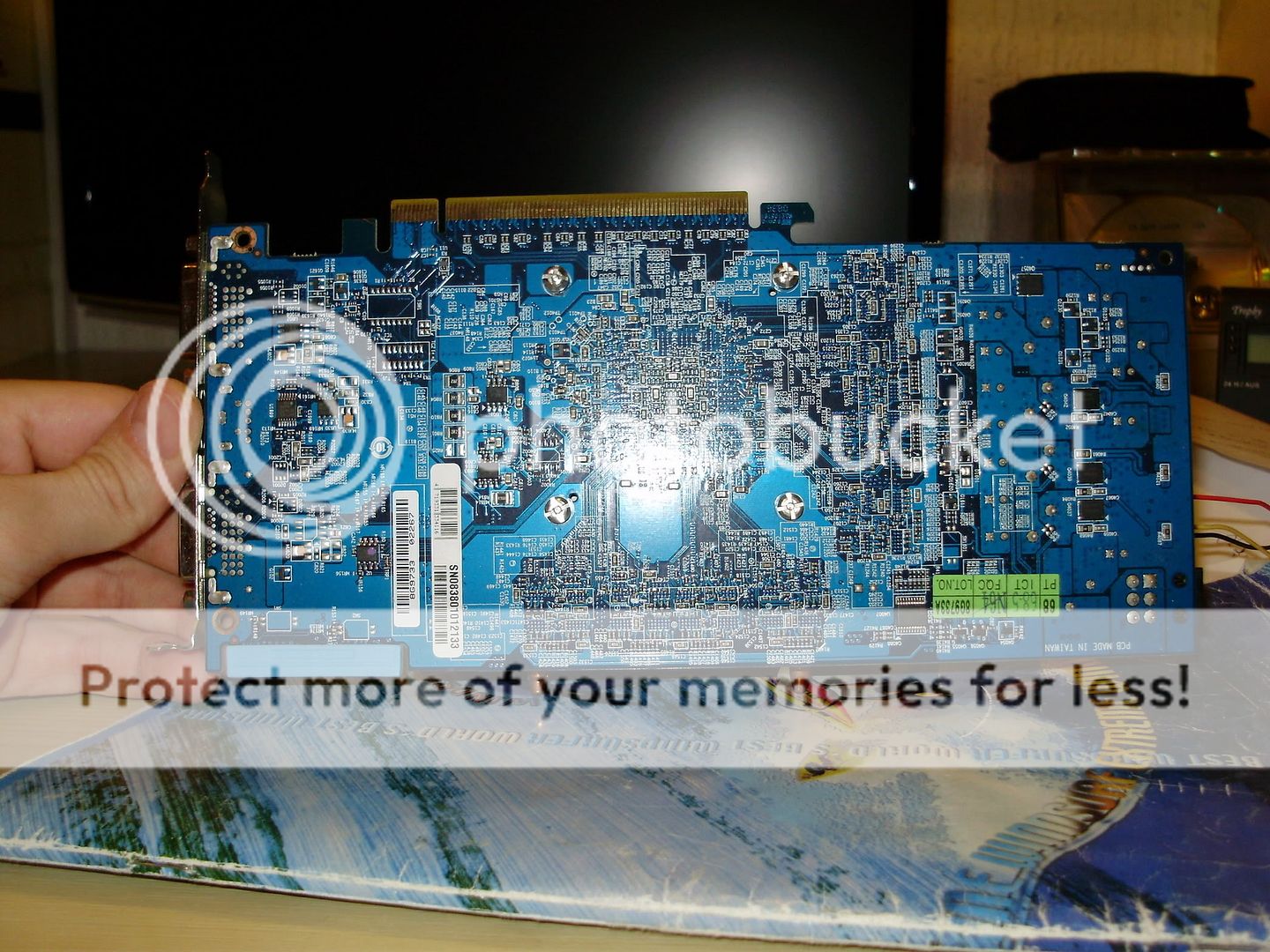

HI there ;
can any one help with this card : palit sonic non reference design ?
if possible the pencil mod for the gpu , if not just the GPU soldering mod .
http://www.xtupload.com/new/image-F8E6_4A0368B8.jpg
http://www.xtupload.com/new/image-A075_4A0368B8.jpg
Have a look at these two pics:
http://www.hs-augsburg.de/~ingmar_k/vgpu.jpeg
http://www.hs-augsburg.de/~ingmar_k/vmem.jpeg
And then give me the details.
http://www.xtupload.com/new/image-2B8F_4A055D1F.jpg
http://www.xtupload.com/new/image-60C0_4A055D1F.jpg
Thanks
Hi there i tried to write the marking but this was pretty hard since the latter are almost erased , for the VGPU image it was impossible to read the hole marking i just wrote what was possible , sorry .
The question is is pencil vGPU mod possible ?.
EDIT : after more checking the gpu chip marking in 90% : ncp 5388
A trick to make the markings visible is taking a q-tip, rubbing some white thermal paste on it and then smear that onto the chip markings. Then remove the thermal paste again, maybe using another new qtip. Now the white thermal paste should've left some residues on the chip, which should make the markings a lot clearer. ;)
And concerning the pencil mod question:
I will tell you what resistances are needed and between which pins. I won't tell you exactly where to pencil. For one, because pencils should be used for writing and not for vmodding hardware. Anyone who thinks that a pencil is perfect for influencing a feedback line and getting long-term stable results that way, should seriously rethink that.:up:
So, please check the markings again to make sure they are correct.
Hi there ;
thanks for your reply
I confirm the chip is ncp 5388
note : i tried the volt mod ((just like the sapphire card using the same voltage controller)) to the pin 19 (50 h vr) but this result in black screen , i tested the vgpu and found it was 0 . So the point was wrong . could u please check with me .
here the point market in blue.
http://www.xtupload.com/new/image-8E23_4A071EB9.jpg
You know that you probably killed your card?
That's why you always need to double/triple check. Just because a circuit looks like another one, or uses one identical chip doesn't mean that it is the same. Will have a thorough look at it when I find the time.

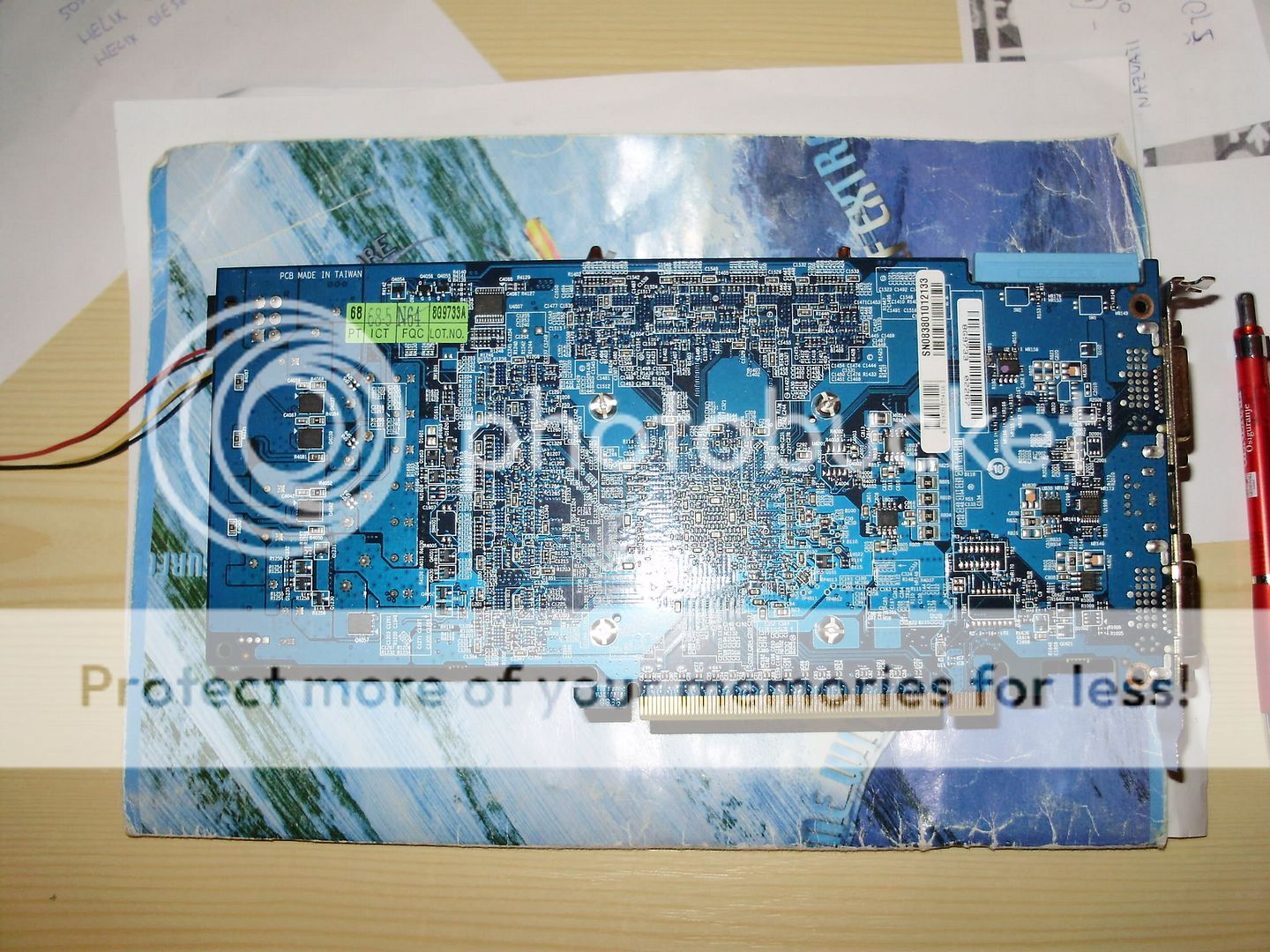

HI there ;
After checking i found that the pin 14 is not directly connected to any other point . this is clear from the PCB pic ,
so even if not directly connected can i solder to it ?
pin14 probably "dives" into PCB where it's connected to GND. So You have to use some other GND point near that IC. celemine1Gig might know it better...
Yep, normally any GND point should work. The best option would be to use a point directly connected to AGND, as this is the real reference for the feedback line, but as AGND and GND shouldn't differ by much (AGND should be less prone to interference), it should theoretically not matter at all if you used just GND instead. The difference between GND and AGND as reference should max. be in the mV range.
And now post a highres picture with your exact solder points, for other poeple with the same card, as reference. ;) I mean, I know how to work out mods, but others obviously don't, so this way you can give something back to the community.

Is there a pencil vgpu mod for the Gigabyte 4850 512mb? Or soldering mod?
Here are the pictures http://i696.photobucket.com/albums/v...h_P5250409.jpg http://i696.photobucket.com/albums/v...h_P5250416.jpg http://i696.photobucket.com/albums/v...h_P5250417.jpg
there is no known pencil mod for the card , go with hard mod for stable voltage

Hello, can you please help me which resistor to pencil on the Gigabyte HD4850 (zalman, 512MB) ? I took some pictures, http://img56.imageshack.us/img56/8844/dsc04298.th.jpg http://img56.imageshack.us/img56/4900/dsc04301.th.jpg.
Thanks in advance!
