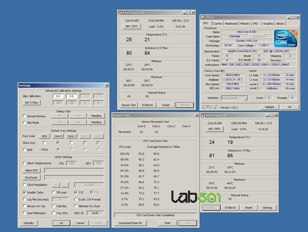

Hey Kevin,
now everything looks normal :)
http://lab501.ro/forum/attachment.ph...1&d=1256059381
A 32nm hyper threaded dual core looks like fun. I hate heat and fan noise so this finally looks like a CPU I'd like to have; once all the Foxconn sockets are off the market.
RealTemp still needs to call your new CPU a Core i5 instead of a Core i7 but at 4.7 GHz, who cares? :D
I think I fixed that minor bug in version 3.37 or 3.38
http://img14.imageshack.us/img14/4531/i5650.png
http://www.fileden.com/files/2008/3/...alTempBeta.zip
The significant difference in core temperature at full load while running Prime 95 Small FFTs looks like more evidence that Intel "accidentally" sets TJMax slightly higher on core 1 compared to core 0 to better control thermal throttling. ;)

Anyway, the i7 bug is solved. Here ya go:
http://lab501.ro/wp-content/uploads/2009/10/RT-338.jpg
Thanks for showing me that. I thought I fixed that but I lose track sometimes. :)
There's no major difference between 3.38 and 3.37 so you're not missing anything important. It was some minor adjustment for a mobile CPU. I think I uploaded it to SendSpace instead of my regular FileDen.
