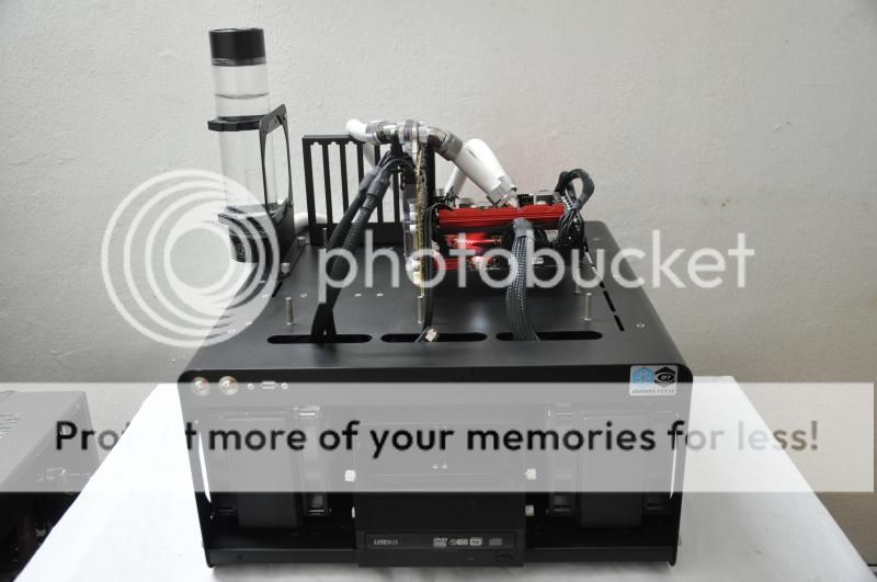

Team Xtreem 2666C11 (Hynix-MFR) @ 3466MHz 12-16-15-35-1T @ 1.955v on ASUS Maximus VI Impact | CPU water / RAM air
