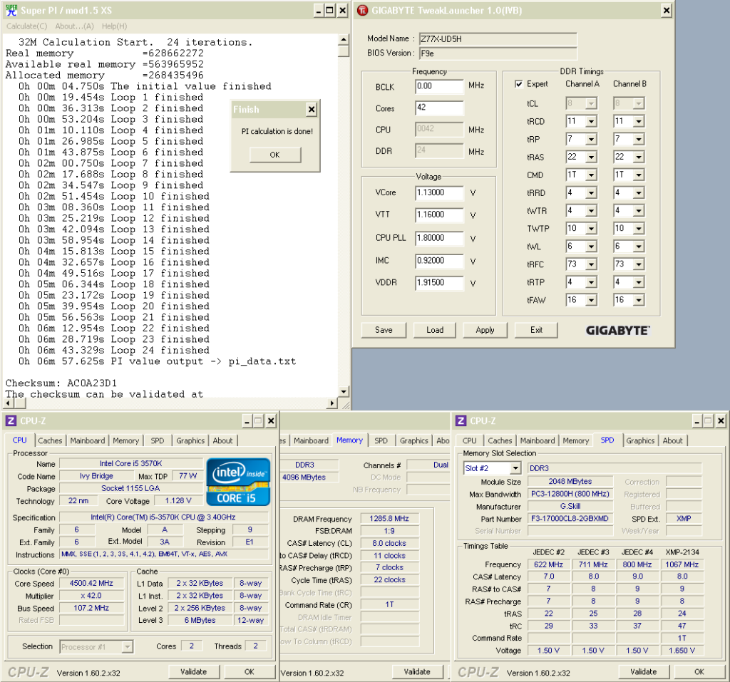

I just try this:
On slot ddr3_2 with both sticks one by one:
http://i.imgur.com/zFgmXl.jpg
On slot ddr3_1 won`t POST with 24 and above.
I just try this:
I would say that rules out the CPU then.... got to be the board/bios as the RAM is previously tested & the CPU can at least boot 2700.
