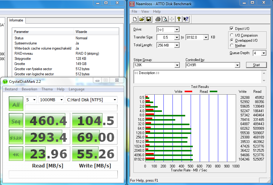

160GB G2 RAID 0
Vista 64
ICHR10
256 sector offset/128KB stripe size
To be honest I'm not sure about the validity of this bench. It seems rather inconsistent to me. In general use the volume feels pretty fast though. Just going by feel I can tell the difference between this and a single 80GB G1.
Thanks for the reply, yeah this benchmark isnt consistent at all but still it should give a rough idea after several runs.

I've also ran the CrystalDiskMark test without the CPU down clocking at low loads. It improved my 512K and 4K speeds by 8-10%. I found out after the fact that my CPU was at its minimum speed of around 1.8Ghz when I ran the test for you. Maybe your CPU is doing the same?
CPU is running fullspeed al the time so no power saving options enabled.
Im done with my raid setup, one is heading back to the shop and im gonna settle with just one drive.
http://i281.photobucket.com/albums/k...bamR/WTF-1.png
As you see the performance is horrible of my RAID setup, so no real use for two them if i aint getting the performance :(
Do you HDDErase between installs of OS and different alignements/Stripe sizes? If you do not, you will end up where most or all cells are written to pretty fast, in other words "used state", and performance will get worse with every install, atleast untill Trim arrives and the cleanup tool.. The GC/Defrag done in firmware also do not work optimal in raid imho, adding that to an eventual used state, and you are in for some hurting. The GC/Defrag firmware will however, help to keep and maintain the performance after an HDDErase and a clean OS install.....
The ICH9R ecpesially, have a few serious issues with nonmember or raid on the raid controller, iastor.sys timeouts with lower and/or irratic performance and severely slow booting, this can be fixed by updating the option ROM...
And for the love of ***, turn that Volume WriteBack Cache off, it cripples IOPS severely, it might aid HDD's and inflate some useless benches, but it will not aid SSD's where it counts the most..... Also, forget about different alignments, use default 1024, alot of people have already testet this for you, including me ;) ....
