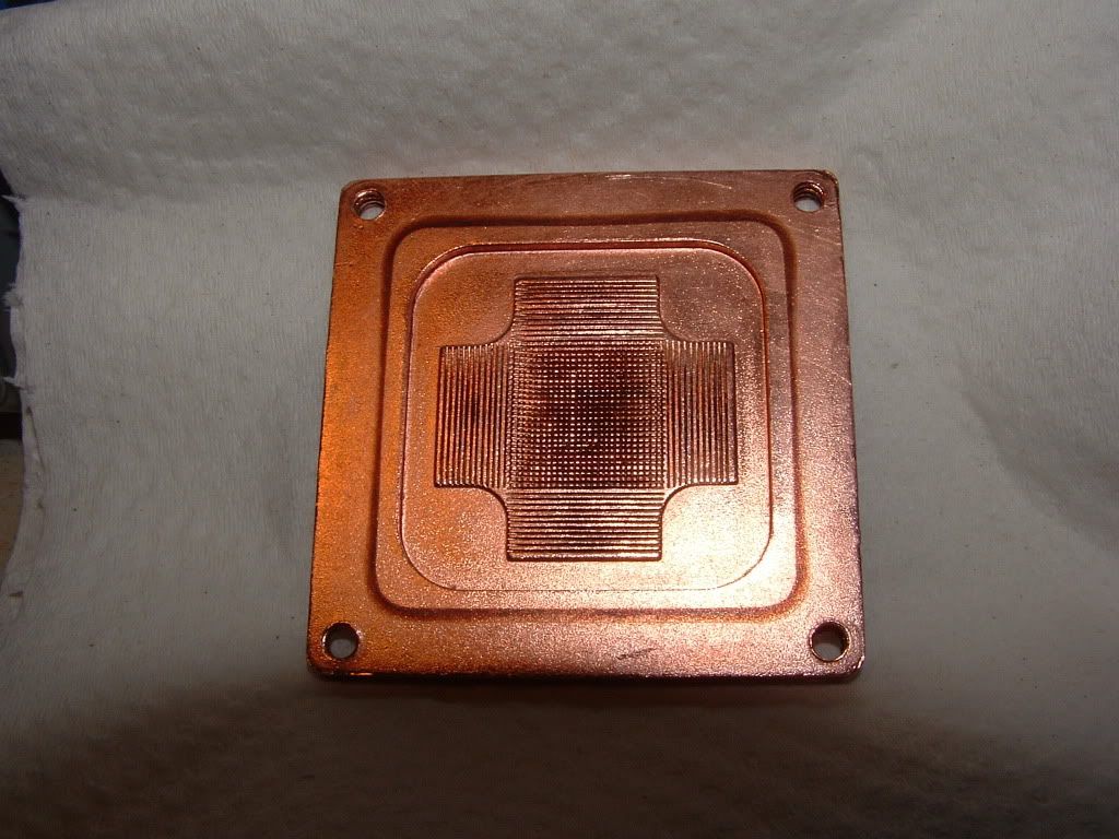

This is how it look after bit of water and a toothbrush. And a needle and paper. Is it good enough, or should i leave it in coke for the night. 7-8 hours.

Lol, it looks fine as-is.

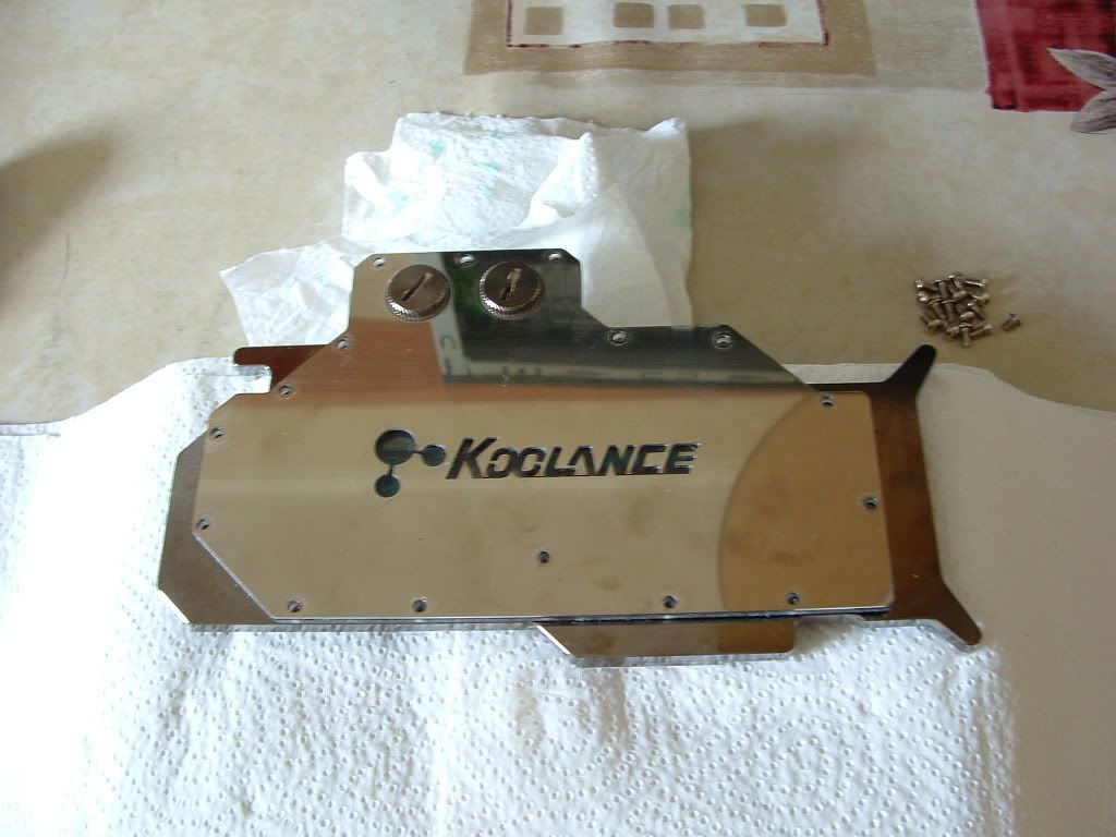

This is how the koolance block looked.
Moment of truth.

The inside just after i opend it..

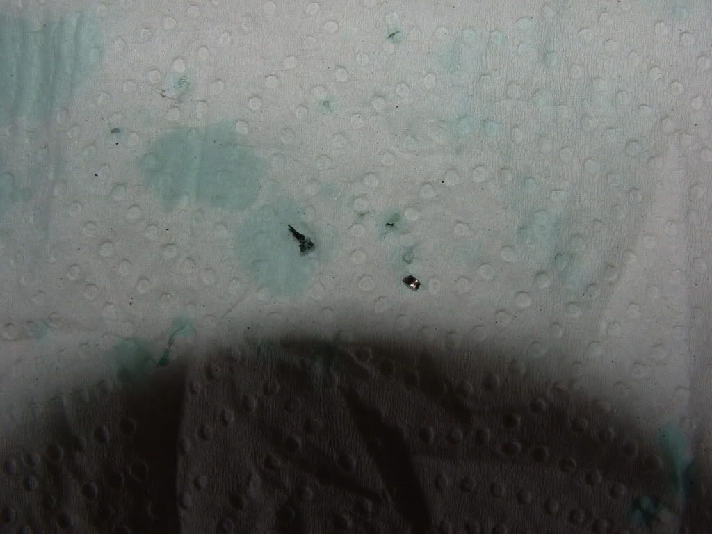

A couple og things i found, one is a piece from one of the square's in the block. The other is something?? And there was threads of some sort stuck to them. Don't know how they got there.. The square shapes in the block are razor sharp, so things like that will get caught up...

BTW, that koolance doesn't look that bad Imo. Or was the blue stuff clogged around the sides of the metal towers?

Feser One plugging your block isn't a surprise really as that pin matrix will act like a filter for your loop and catch anything loose in the coolant including pigment.
