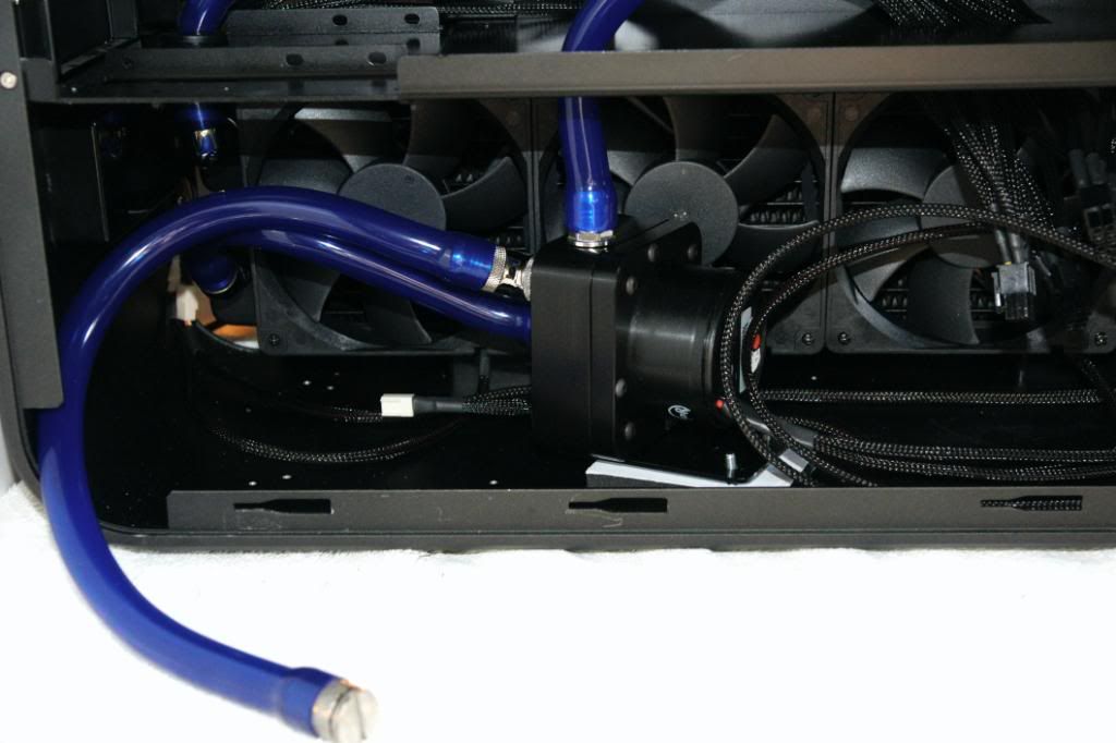

I need some input on this idea. I was trying to find an interesting and appealing way to drain my system. This is what I came up with....
http://img.photobucket.com/albums/v4...n/DSC01665.jpg
http://img.photobucket.com/albums/v4...n/DSC01664.jpg
http://img.photobucket.com/albums/v4...n/DSC01666.jpg
Will this work?
I could use an Aqua shut off valve but it just does not look good.
koolance male QD.
Get the stubby one tho seeker, since its just a drain and your not gonna be primary concerned with flow.
i'll remove this pic after you post.
I think it would work. It would be at a low point in your system and would be able to drain a good amount of fluid out. It's probably a better option than cutting a tube off, which is what I do currently.

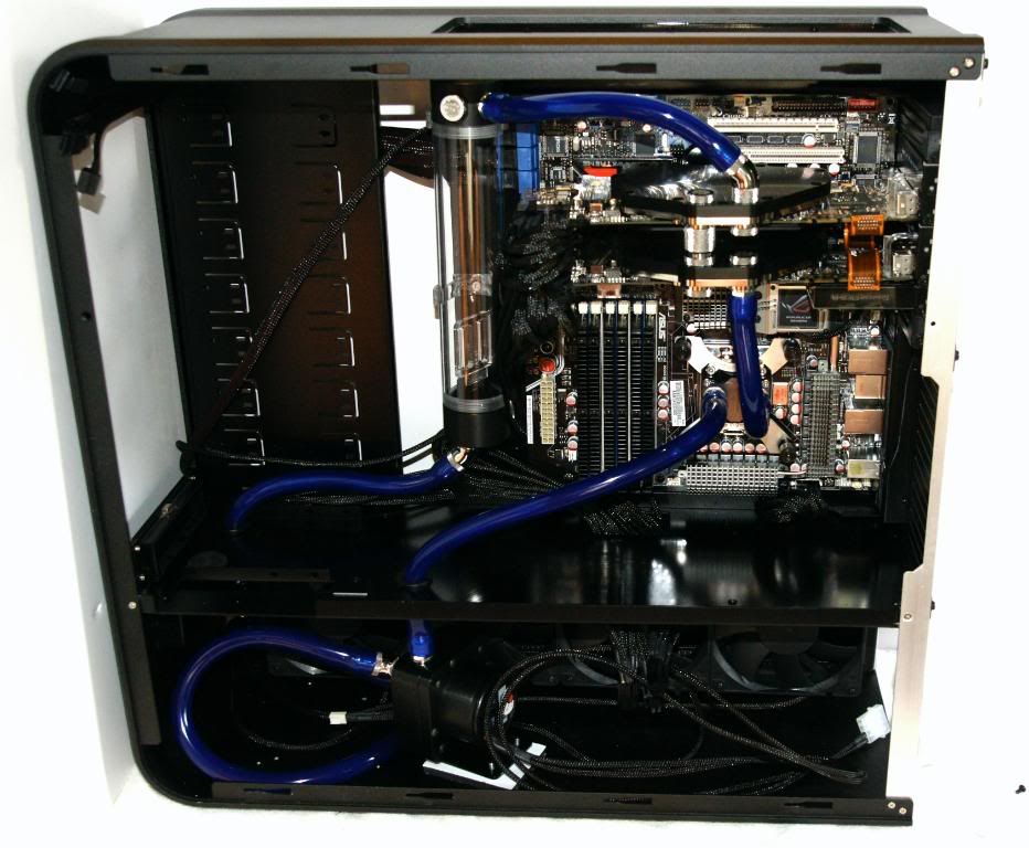

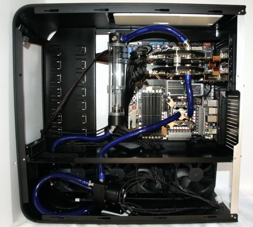

I spent all day working on the "Madness" and it is amazing how little it appears I accomplished. Here are a few pics.........

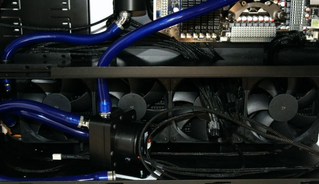

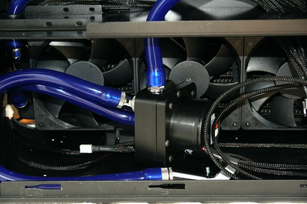

The run from the pump to the CPU is as short as I could possibly manage...for BA and Headala!
http://img.photobucket.com/albums/v4...n/DSC01674.jpg
Obviously I chose to use the 45 out of the Res. The rotary 90 actually worke better but I didn't like the look nor the restriction it might cause....

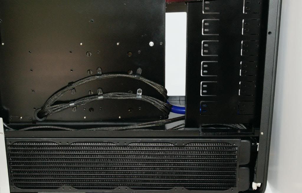

This Rad is big!
http://img.photobucket.com/albums/v4...n/DSC01668.jpg

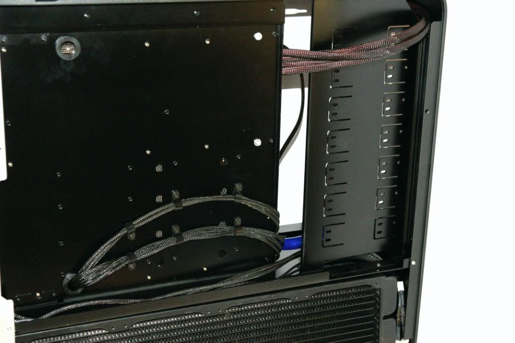

A couple of points; the pad under the pump and the hardware are temporary and so is the white molex on the pump. Please excuse the all the wires hanging around. I connected the five SATA cables as they are behind the Res and I didn't want to keep pulling it out.

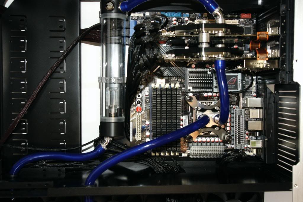

I started this build on January the 8th and feels like it has taken six months to get to this point! However, since this is my first build of this type I am pretty happy with it, I just hope it boots!
LMK what you think. I truly appreciate all of the advice, feedback and suggestions that many of you have offered. Please don't stop now!
progress looks fantastic...that rad JUST fits in there...like a glove...looks very NICE! - i like the flow of wires on the rear of the mb tray :)
one suggestion...i think that your current SATA's are red...are they not?
with as black as this build is & there is no other red in existance anywhere else...maybe get some black ones :shrug:

did your pump top come with that hole built into it or is that a custom job ?
Thanks! Yes, the SATA's are red and they only show through when I over expose. They will not be seen once everything is finished. However, great point and I will not make this mistake again!
Thanks Jokester! This is the EK Rev 2 pump top, it is stock.
This is coming along very nicely, it is clean and well thought out. I do like the loop from the cpu to the vid card more each time I see it, it flows well.
I think that NaeKuh's advice about the QC for a drain would look fine if you used the stubby female out of a rotary 45. Or you could run the tube to the rear of the case and use a bulk-head fitting to put a QC on the back.

Wow Rocky.. I have to say that your radiator is HUGE. The size really looks fitting for the TJ07 and should prove to be a worthy asset in your water cooling system.
Great progress though, it looks like you've put a lot of work into getting it just right. It's more time consuming that most imagine. I just hope you don't have sleepless night figuring out where you're going to place your pump like I did.
Looking at the drain plug idea, I can't see how it would be an easy drain process. Given the construction of the D5 top, I would imagine you will have to rock your case back and forth a lot in order to drain your radiator. I know it isn't as sexy of an otpion, but a regular T fitting attached to the lower barb of the radiator would drain the system like a champ and since it is in the lower chamber would basically be out of sight. Just a thought.
